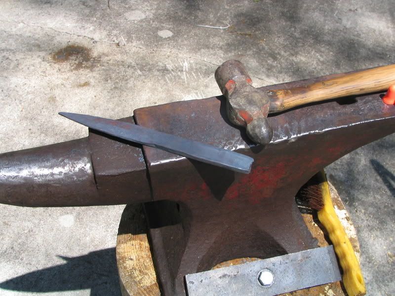

How do you attach your anvil to a stump?
Jun 16, 2008
987
Hey guys, we have an anvil in the shop (not knife making, general shaping and pounding) and my uncle got a big stump for it, we need to level it off still but I was wondering how you attach your anvil to your stump? seems like a bit of a hazard to just have it sitting there. the stump isn't that huge in diameter.
also, about what height do you put it at? I figured about 36-38" to top of anvil, so I don't have to bend over straining the back.

What I did (and it works really well) was to just take a couple pieces of angle iron and use them as braces to hold the feet down. The whole deal is just lagged into my "stump".
As for height, the general rule of thumb is to have the anvil face at the height of your knuckles with your arm just hanging next to your body with your hand in a fist.

I got some heavy chain and wrapped it around the anvil then I used Lag Bolts and washers to hold the chain to the stump. This also cuts down on the ringing.;)
This is my Peter Wright 153#.
