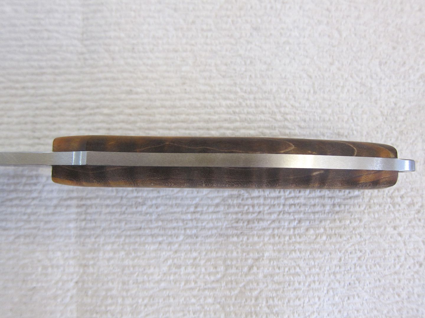

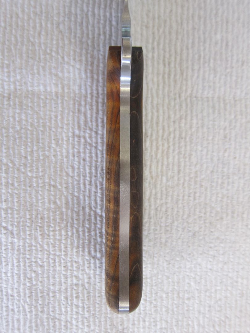

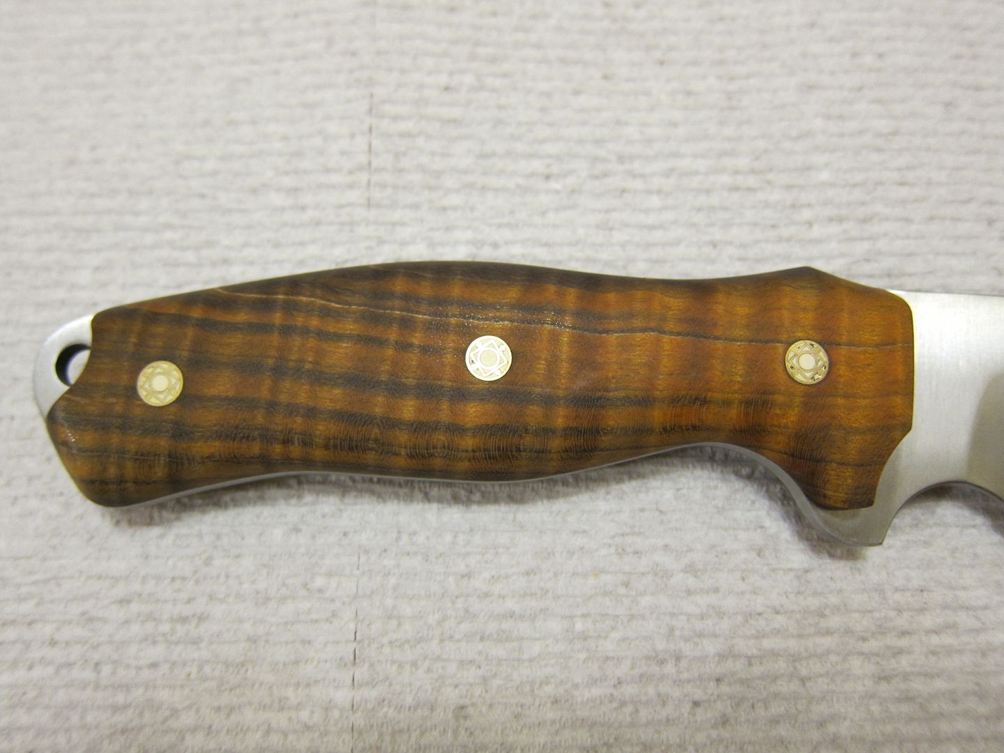

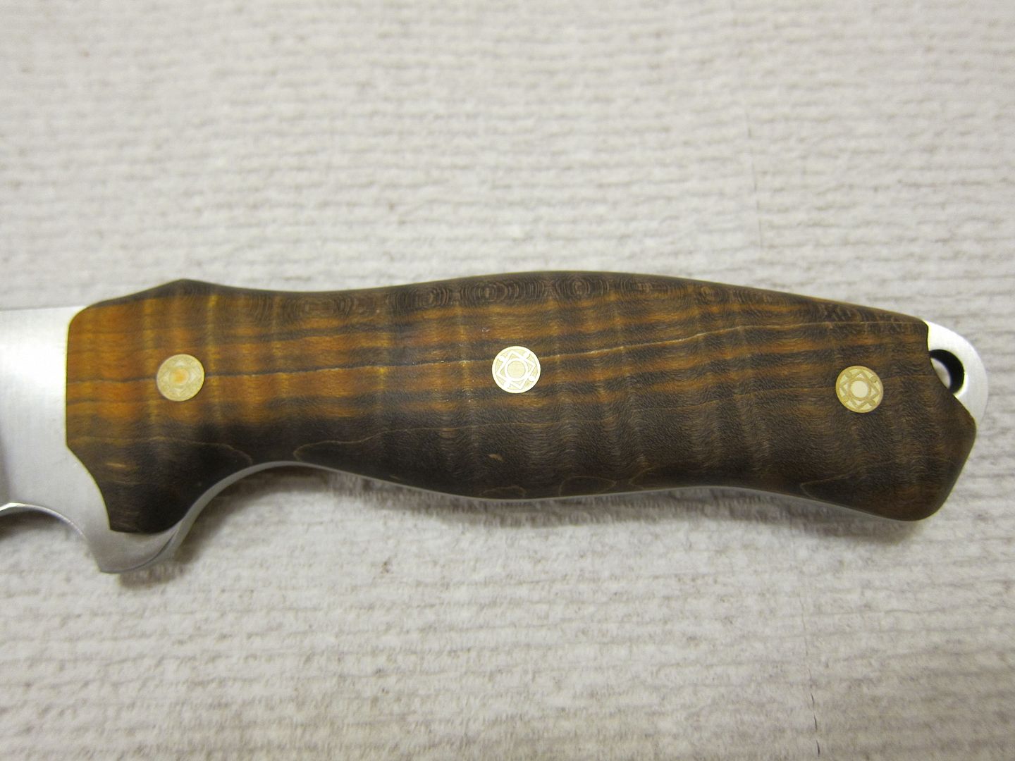

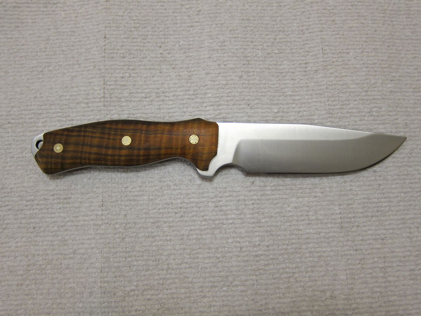

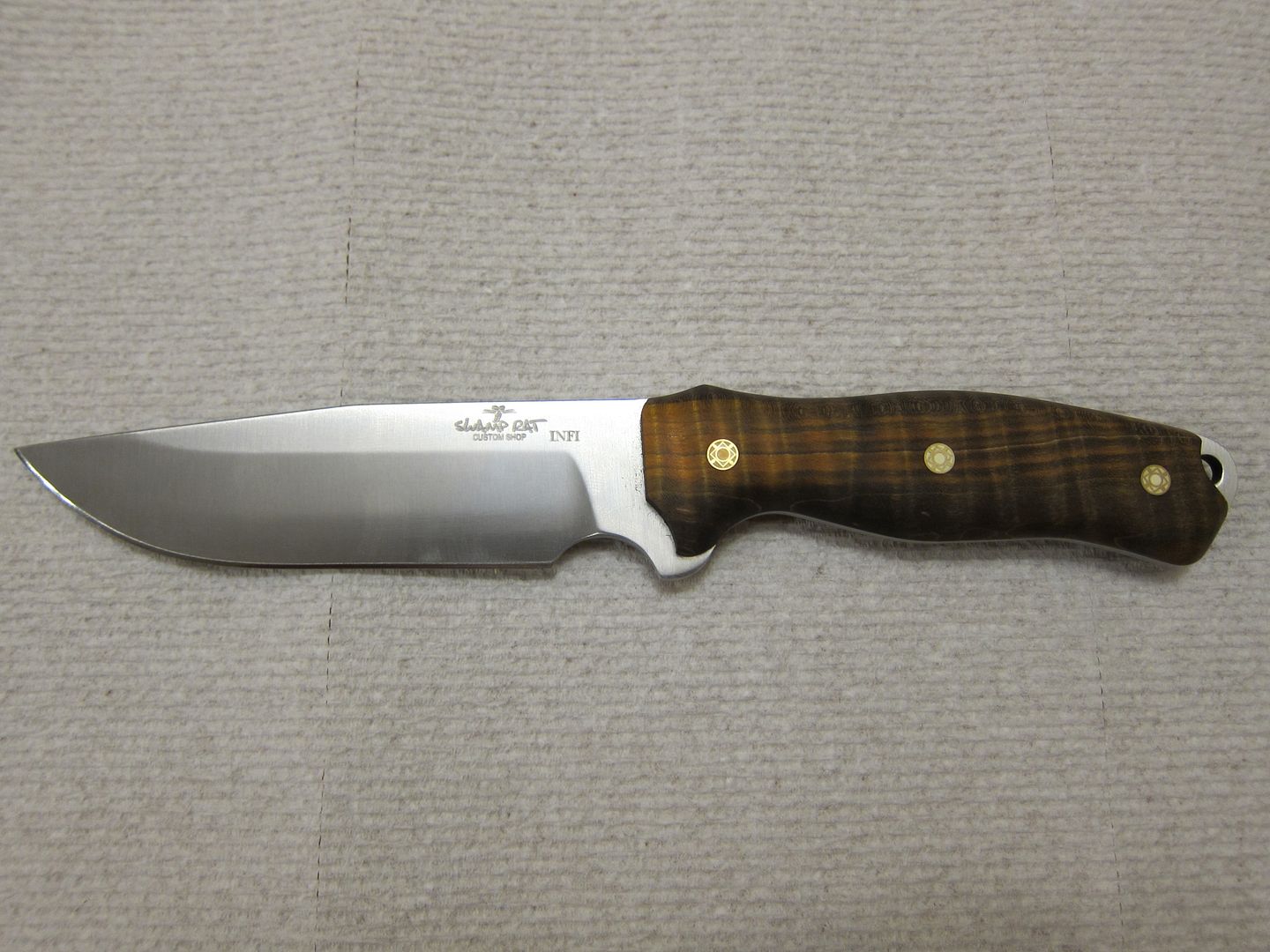

Here is the knife.
....The wood on your CS MSE is dyed and stabilized and should behave much like any other phenolic.
Thanks. I'm not an aficionado of wood but the grain is kind of stringy and porous like oak. It does look like those capillaries might be full of black acrylic but it's kind of hard to tell for sure because when I drag a fingernail across them you can still feel them. On my stabilized wood duck calls you can't feel that, but I dont have any oak duck calls. Come duck season I'm going to use the heck out of it and see what happens.

I used to own the only other one I've seen exactly like this... Sweet knife. I remember the scales being some kind of maple
