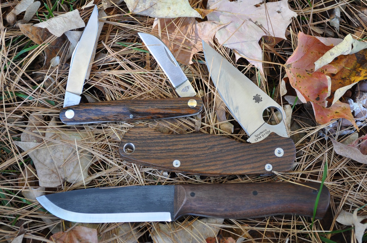

My S110v PM2 has been wearing bocote since a day or two after I got it.

Bocote, as stated :thumbsup:
Also, to note, the craftsmanship is not mine...the PM2 scales were made by Cuscadi. (The wood on the other knives is stock -bocote on the traditional, walnut on the fixed)
