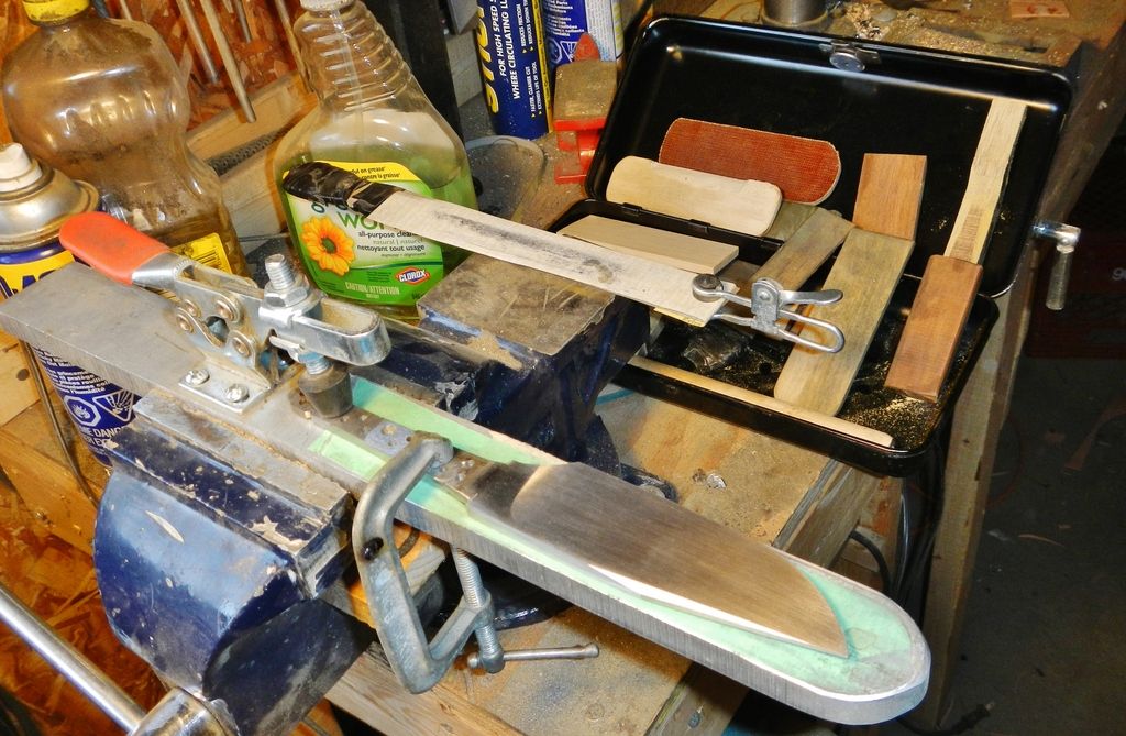

a couple of tips i have learned are:
1. get yourself a jig to hold your blades flat and stable while sanding... saves trying to clamp the tang with blocks of wood in a vice and dealing with blade wobble while sanding.
2. make a bunch of sanding sticks in different shapes out of various materials to try them and see what works for you... if budget is an issue, start with paint stirring sticks and electrical tape.
3. +1on what greenjebadiah said "USE GOOD SAND PAPER and change it OFTEN" (this happens quickly). I use NORTON with windex (thanks to Nicks videos) exclusively until i get to 400 grit, then i switch to wet dry paper and light cooking oil or WD40 as well.
4. Get your blades as finished as possible before heat treating... it's sooooo much easier to get scratches out of annealed steel than it is at RC 59.
5. sand different grits in different directions to ensure the scratches are gone before moving to the next grit.
Hope this helps
here's a pic of my hand sanding set up. all made with a couple clamps from princess auto and scraps.
