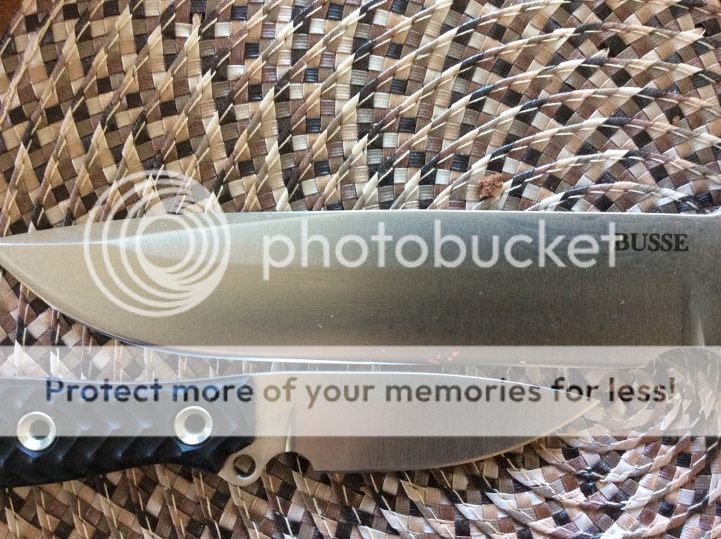

You know, at first I was enamoured with kydex sheaths but a number of my new busse satin blades are now scratched; it doesn't seem to occur on the coated blades. Is there a simple, at home, way to get superficial scratches and draw marks off a satin blade? Please, nothing complicated here. I'm trying to change over to leather sheaths but it would be nice to start with pristine blades. This is my first post guys. Your attention is appreciated. R H Wingert

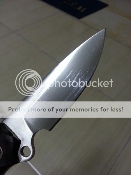

Sometimes those scratches are actually smears of kydex , a picture will help to determine what is the best option.

I use 2000 grit sandpaper. It is actually called polishing paper. If you go from spine to edge and not the length of the blade it will take very light scratches out. You will need to do both sides for uniformity. The knife will NOT look like the factory finish but it should clean it up without taking too much material off. Sounds like you do not plan to use your knives . . . . a little scratching give them some character. USE THOSE BUSSE KNIVES!
The satin finished blades have a "satin" coating in them. I used some flitz on a paper towel to buff out some scratches I had on a Tank Buster but it left some noticeably "polished areas". I just lightly polished the whole blade so it was more uniform. I'm planning to keep/use it so it doesn't bother me but it does look a little different than the factory finish.

I'll add my vote for scotch brite. It won't be exactly like the factory satin but still looks fine to me. I've done it to a few of my blades.
I completely remove scratches and get a nice satin finish with the scotch bright pads from the paint store.
If the scratches are very deep I wet sand them out with 1200 then go to the pad.
