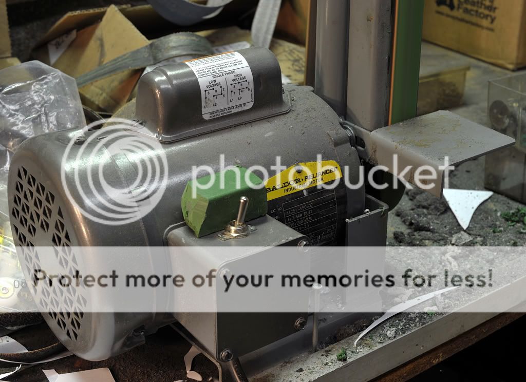

I was using the white compound with incredible results. Then I tried the green (coarser) and it push cuts just as well and really has a scary bite on flesh and other similar materials.

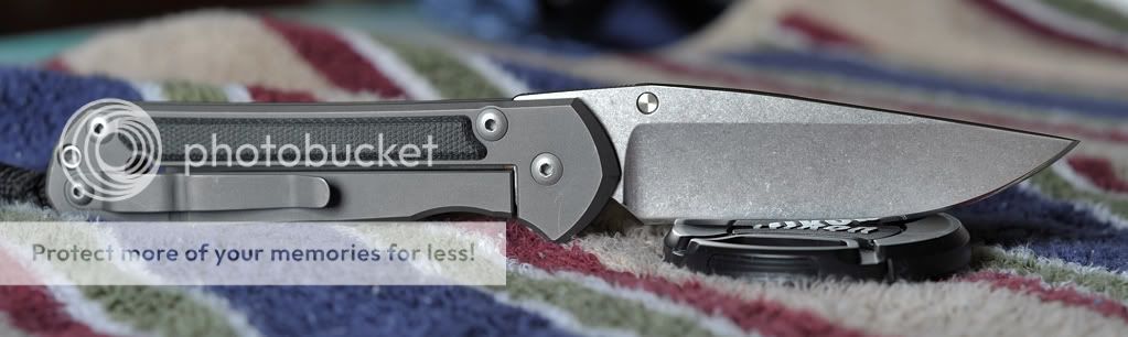

It just keeps getting sharper. Here is what I am using for S30V now:
I initially created the edge with an abrasive belt but I have not needed to go back yet. If it gets bad I can always use black compound followed by green.
I would say this is the fastest, easiest, and most effective sharpening technique I have found.
