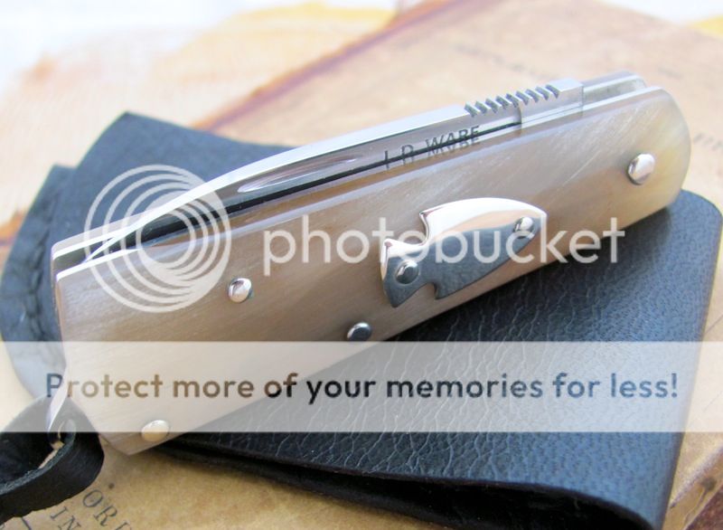

MT…… I use real 23kt gold leaf as a backing under translucent horn scales on folding knives. I tried some traditional sizings, but found them to be a "weak link" in the handle scale / liner connection. After applying the gold leaf to the underside of the horn scale with sizing, I then epoxied the scale to the nickel silver liner. Prior to pinning, the horn could be easily popped off the liner, leaving the gold epoxied on the liner. So I now use a thin coating of epoxy as the sizing (I always pin the handle material to the liners as well, with or without gold backing)

Here's a photo of one of my knives. In the sunlight the gold really shines through.

Wow Jeff, that looks fantastic!
Interesting way you pinned the shield. Never seen it done that way, but it looks nice. What steel did you use?

Thanks Strigamort. I make the shields from old silver coins - usually early 20th century Mexican 10 centavos, sometimes US Mercury or Roosevelt dimes. They're pinned through the liners before the knife is assembled - the pins are ground flush inside the liner, and domed over on the shield side (helps hold the handle material in place, too) The steel is 440C
