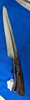

I've always loved fullers on knives and I've worked hard to be able to incoorporate them into my designs where I feel they serve a purpose, like these two Erebos choppers I've recently finished:
I like how the fullers on these turned out and how the primary grind fades into them. Howevery I have not yet been able to do a pretty curved fuller, the straight ones are still challenging for me but I can do them, I struggle a lot more if I have to do a curved one.
How do you approach a curved fuller? Any tips?

I would bet 99% are milled in.
Maybe, but I am pretty sure some makers can do it freehand on the edge of a small contact wheel, I just haven't gotten a hang of that technique. Besides I don't own a mill so it wouldn't be an option for me personally anyway.
Another thing I've thought about is using a rotary tool like a foredom with a small flap disc attached like on an angle grinder but where the abrasive is not attached on the flat of the disk but on the edge...if that makes sense. You theoretically can remove material in a more controlled way and can see a lot better where you're removing material. Im just not sure where I'd get something like that.
Make a small collar to go on the dremel or something, with an adjustable stand off leg, think of the same principle as dividers or verniers to hold the wheel perfectly even away from the edge of the blade.

I used handpieces far better than a Dremel almost every day for 50 years, and can tell you that it would be dicey to try a curved fuller by hand with one ... even with a guide.
The Japanese sen is the tool traditionally used to shave the blade down, and to carve bo-hi (fullers). It is like a draw knife. The ones for bo-hi have a small, curved bit, like a lathe tool, to shave out the steel groove. They bo-hi sen usually have a guide arm that spaces the bo-hi from the spine. It should work fine on a curve.

I've got the OBM fuller grinding attachment, but I found it difficult to control in general and especially on a curve. In principle I like the potential for a more organic fuller as the milled slot look is less appealing to me. I'd love to pull off something like you see Jason Knight do.
This was my first try with the OBM attachment.

I use the 2" wheel on bottom of platen to get it started, angle the blade so im mostly using one side of the belt.
