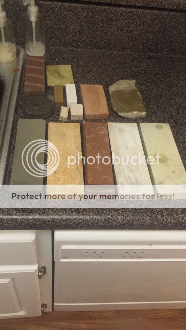

My stones.
Slicing paper or phone book paper is too easy (even push cutting) so I will roll magazine or wax paper into tube and cut at angle (even very sharp knives will glide off, must be very very sharp to bite)
Are those some Jnats I see? I haven't moved into picking those up yet - lately I've been considering Aoto's - since I'm unsure of where to start. Any recommendations?
Japanese natural stones--stones that are mined out of the ground in Japan. Synthetics (like Shapton/Chosera) are manufactured.
Oh yeah then I have 1 natural ( Jyunsyou) and 1 hybrid (hanhan). Also have natural nagura.
As for recommendation I can't help too much because these are new, but I can say I already love them very much.
