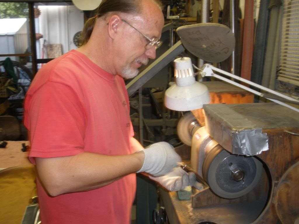

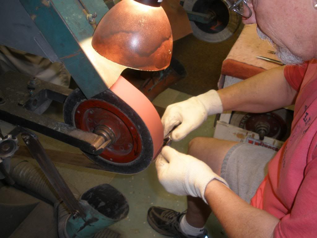

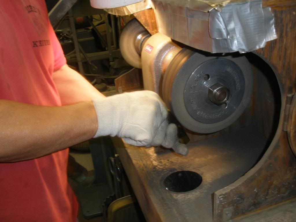

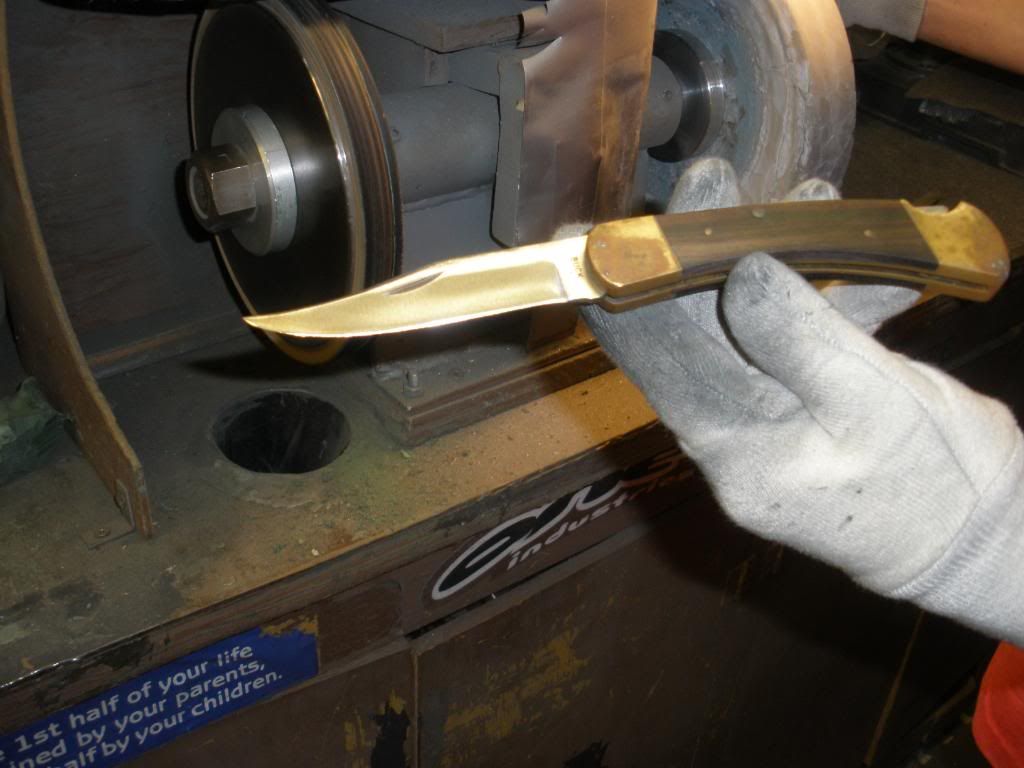

Is teaching folks to sharpen a new sideline for Leroy these days? :D

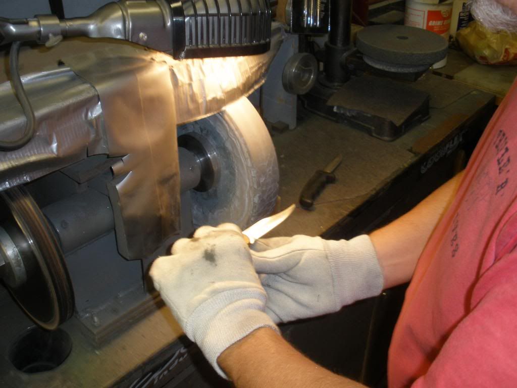

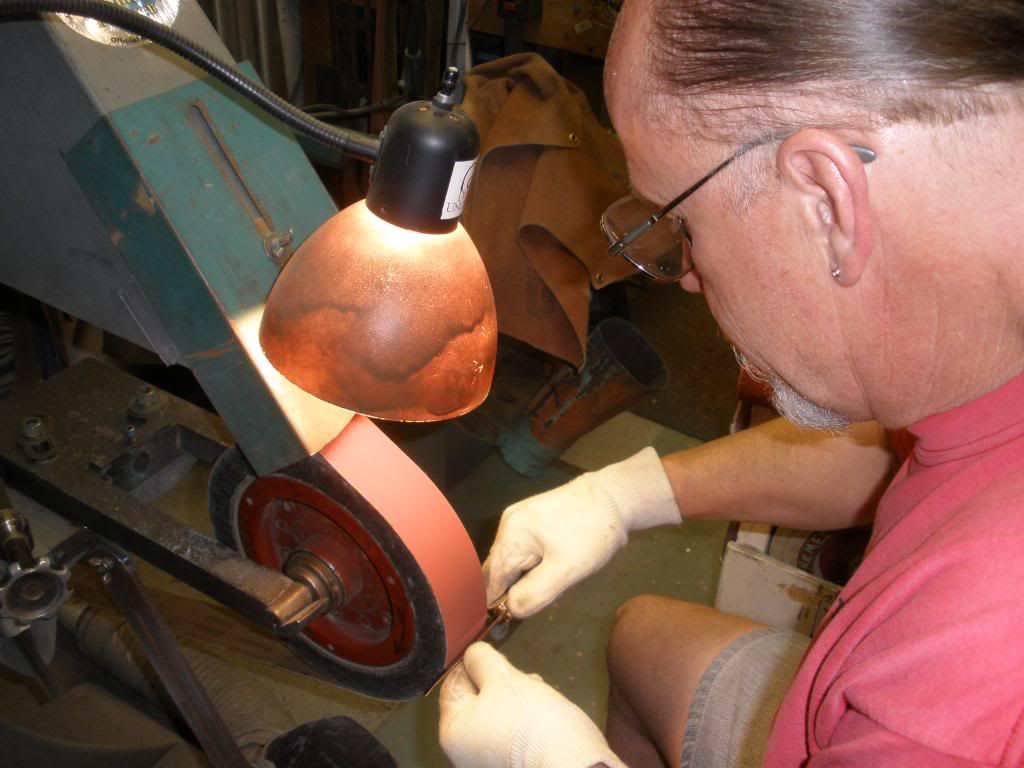

Dave, I don't know... But he did show me how too... I just don't have a sander like his... :( ...
You can ask him if you go to the show in Pasadena in March on the 8th-10th... :D
I might go this time... I hope to see you there... (Saturday) ... :thumbup:

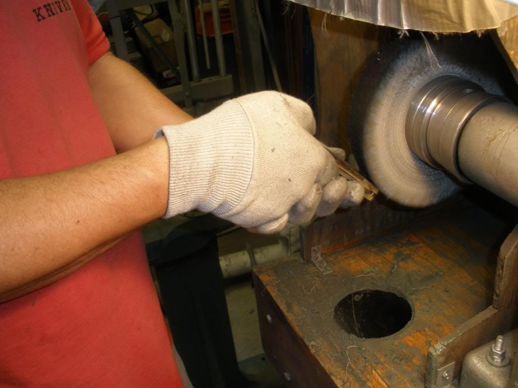

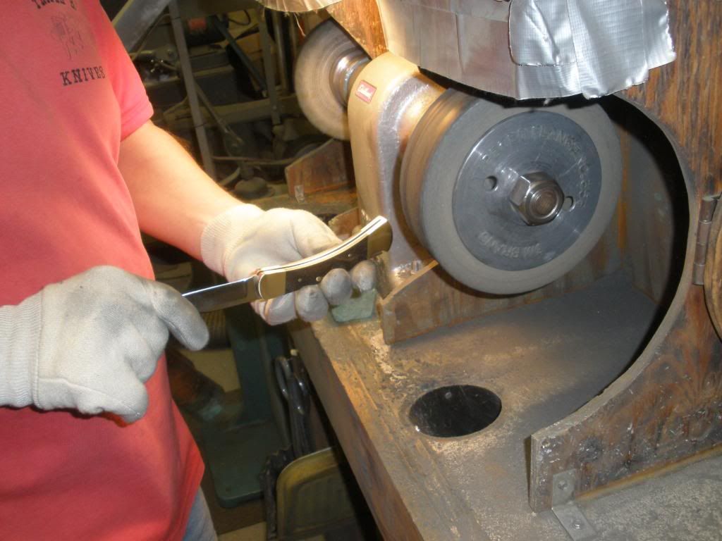

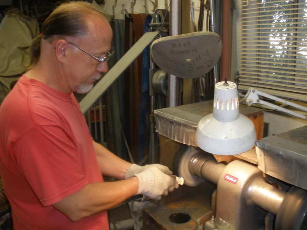

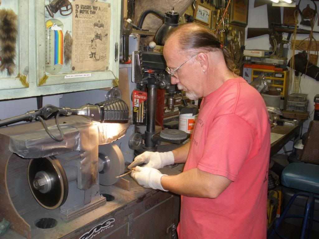

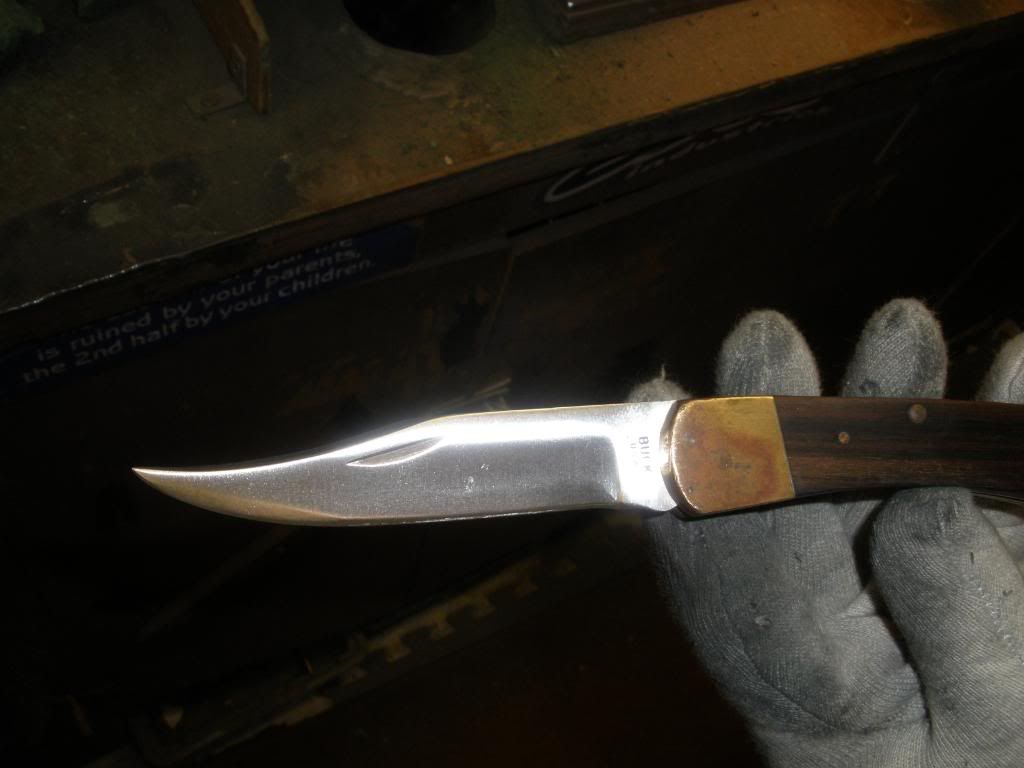

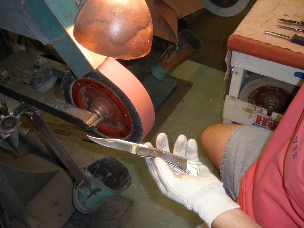

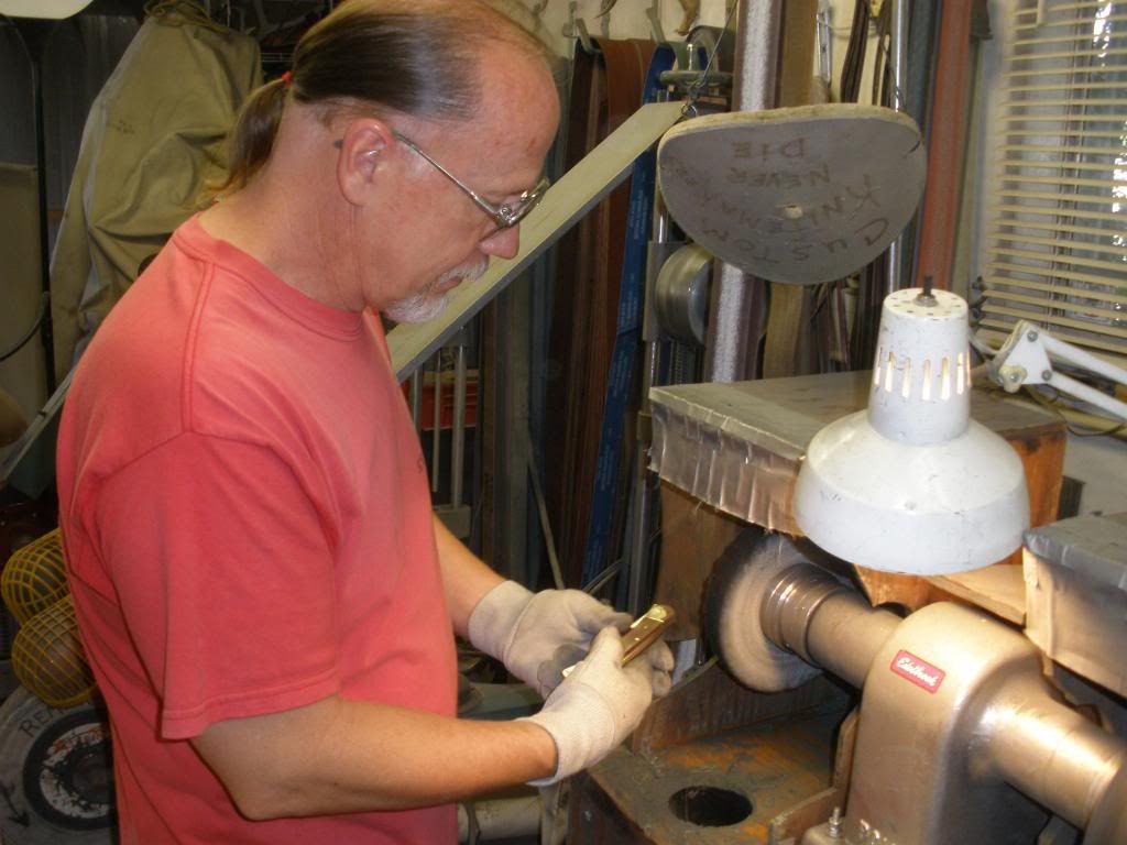

Here's a 110 he did for me... First a spa and then the last 3 pics is him sharping it...

ITE, thank you for the look into the inner sanctum of Leroy Remer who walks the earth like a giant in my eyes. He is to knives what Warren Buffet is to $.
