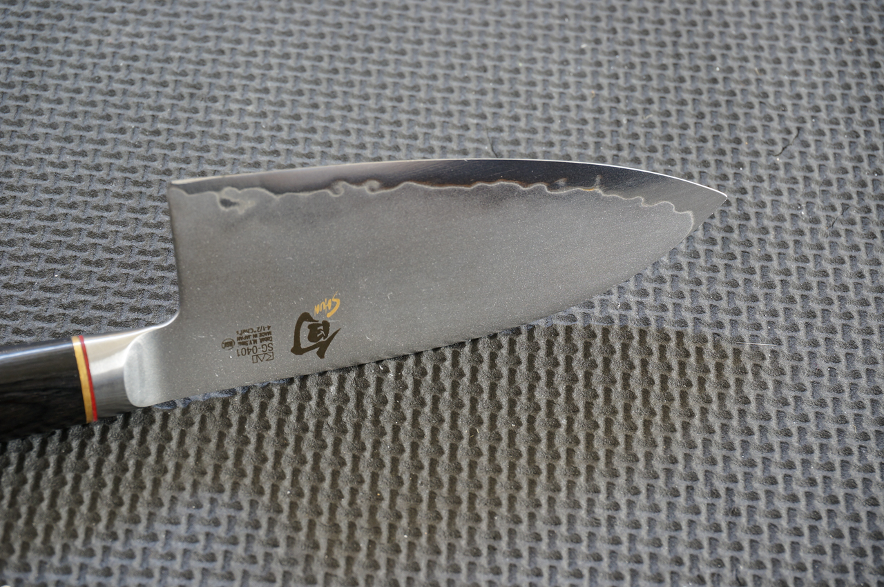

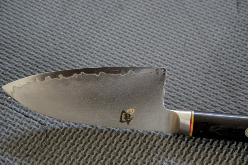

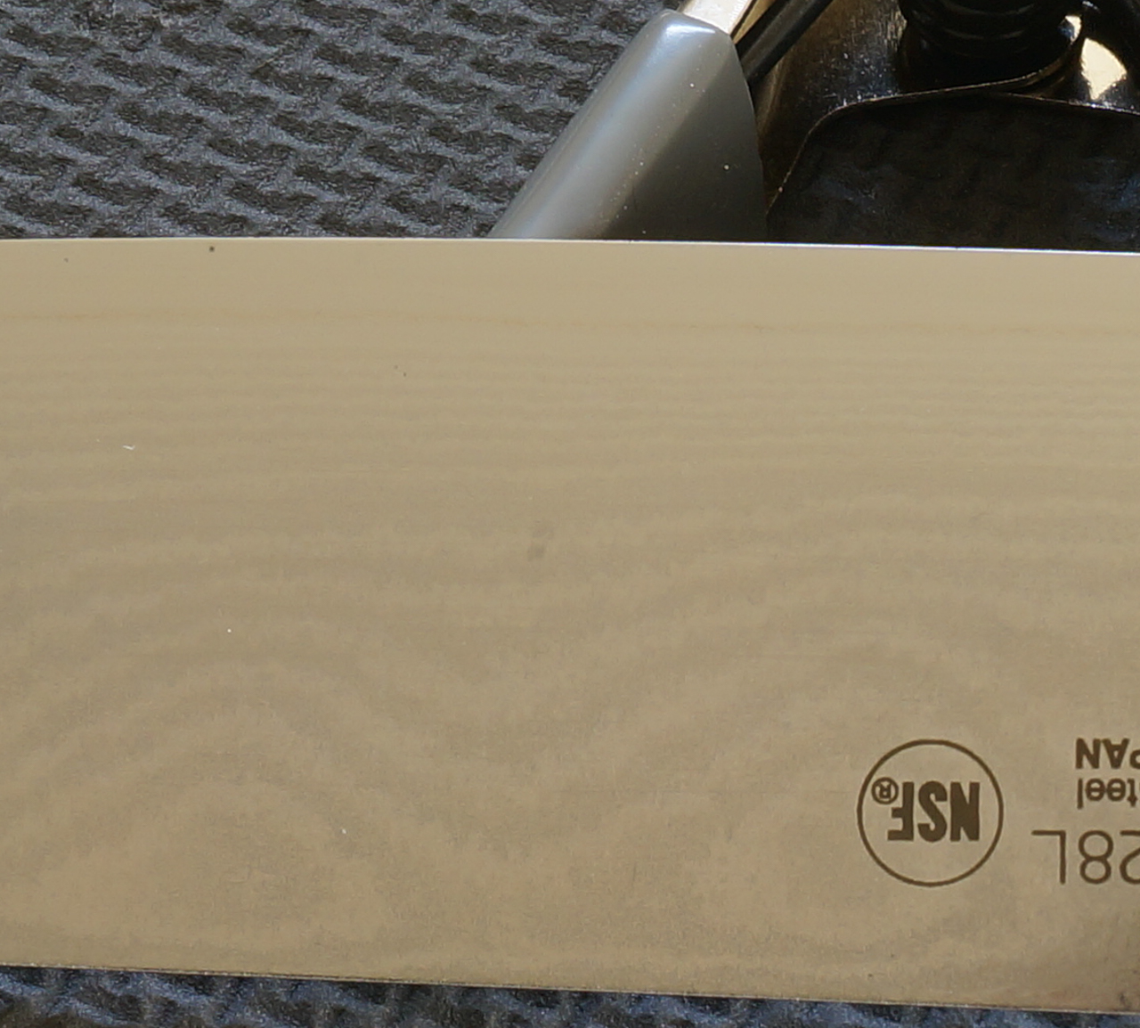

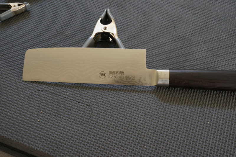

I have a few japanese kitchen knives, and the bevel is so teeny that I can't really discern a bevel (with my old eyes anyway).
So, when using a guided sharpening system, pretty much any angle you draw a stone across the blade edge is going to remove the sharpie. It's too narrow to judge a top and bottom of the bevel.
For knives like these, do you just go with 15 degrees?
Some photos:
The thin white line is all the bevel there is.
Another:
Zoom of the above:
Even magnified, it's barely wider than a thread.

Since you're using a guided system, just pick an angle you like and grind until you have a burr on the other side. From there on, just follow all the basic sharpening steps. 15 dps should be ok for a general use kitchen knife. By the next time you sharpen your knife, you will know exactly which setting on the sharpening system you have to use.

Alot of these Japanese knives do not have the wider edge bevel of western knives. Rather the entire blade is one giant bevel and they just put a microbevel for the edge.
