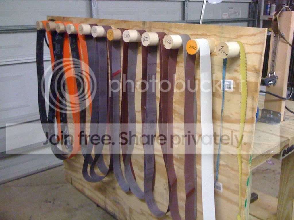

Front of my grinder bench

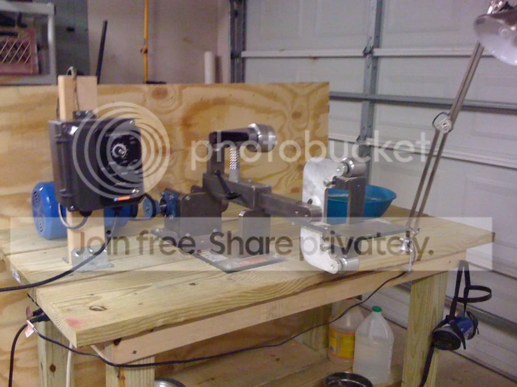

And the back
I keep them in their original boxes to avoid contamination. For belts on the go, I keep those hanging on the wall behind the grinder.
