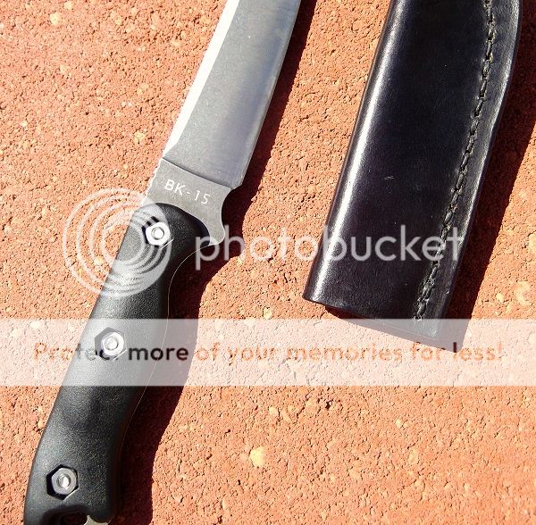

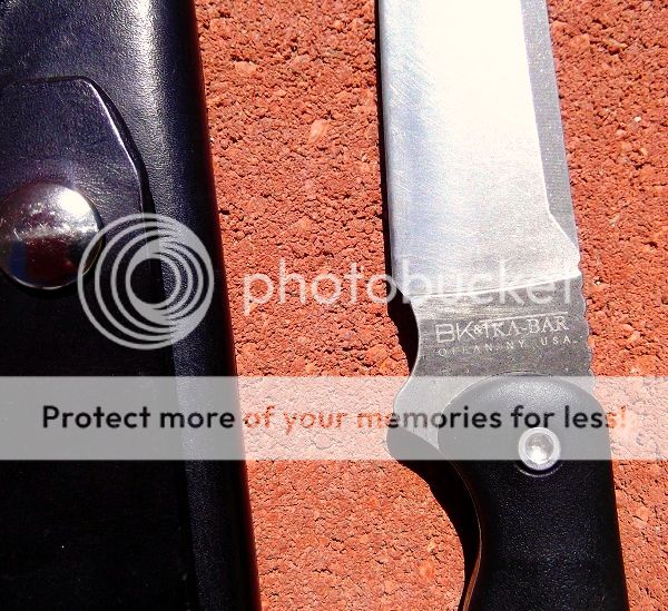

Here are a few pics of laser etching after chemical stripper with nothing done to enhance the etching. Still shows up pretty well.
You can strip it right away,no need for etching. But if you want deeper logo it will be easy to etch it with some etching solution.
