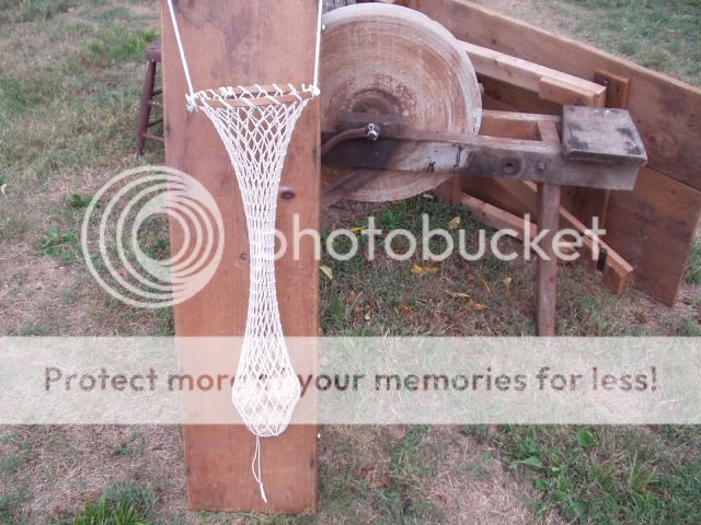

Here is a net I just added to the photo section
Harvesting Bag
Hangs on shoulder. Drawstring at bottom of net opens to release contents. Tony
