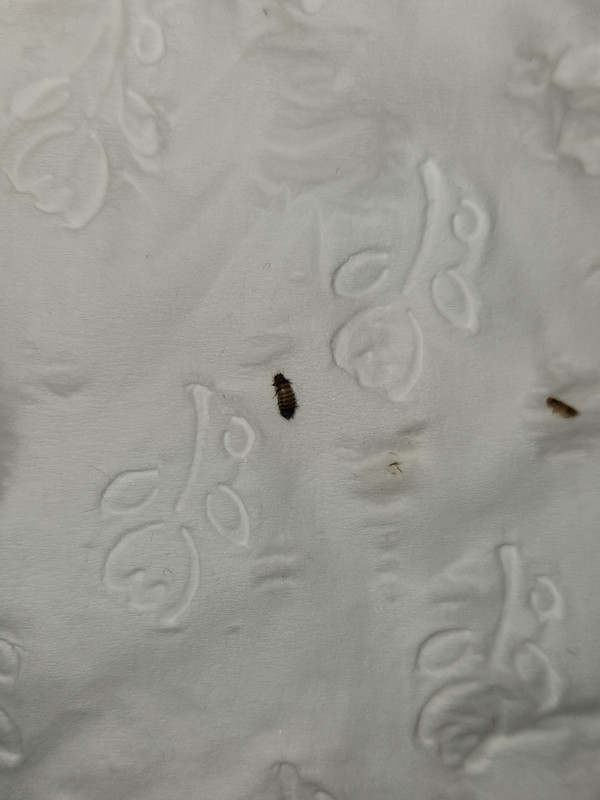

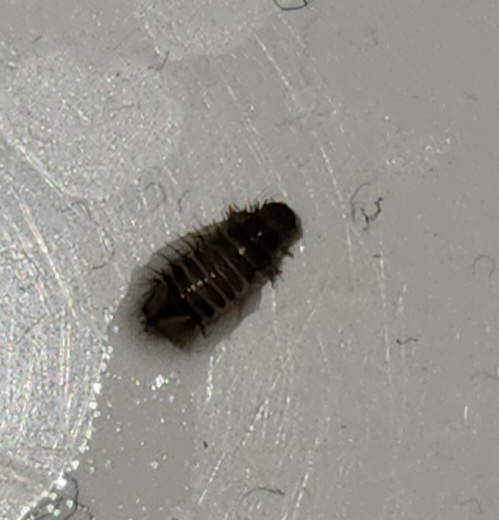

How do you treat and protect your Deer foot handle knives (1930's era and before) from skin beetles and other hide and bone eating pests?

I remember years ago reading about dermastid beetles...if that's what you're dealing with. Placing items in the freezer was one way of dealing with them. (Wrapped of course.)

I don't remember how long I put my dad's knife in the freezer...but it might have been a couple of days. I'm sure the info on freezing dermastid beetles should be available online.

The problem is that they may be in the freezer, but they're wearing a fur coat...
