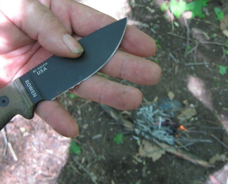

I use the blade on my RC-3. A couple of strikes dosent have a noticable effect on the edge. At least not while using the blade for carving, whittling and food prep. But if you plan on going back home and slicing newspaper you might feel a difference. :D

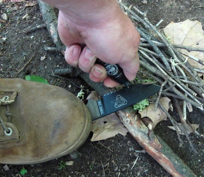

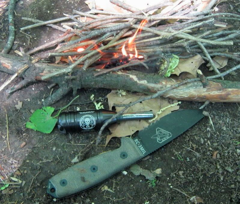

In this pic i used the blade to get a good shower of sparks. As you can see on the blade i used the very tip of the edge.
The thing to remember here, is that if you've done your job right, It's only going to take one pull for fire.
