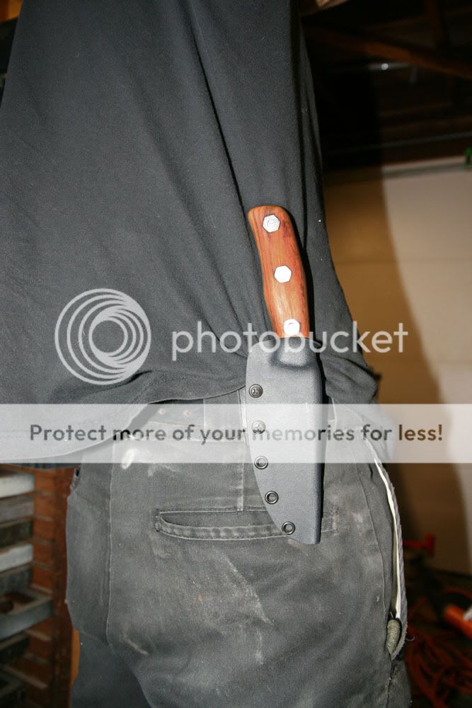

So I got this a while ago (custom shopped sar5):
and modified it into this:
This next picture has TOTALLY inaccurate color representation on the handle. I tried to darken the handle in photoshop to reduce the effect of the flash, but it ended up making it dark reddish brown, when it's closer to the pic above, a lighter beige with dark lines and hints of green.
It's now lignum vitae scales held on by 1/4 20 allen bolts and nuts (both of wich are counter bored/carved/sunk into the scales), and encased in epoxy. The way I have this finished is kinda weird. The lignum vitae is green, and I don't think it would move to much, but knowing it's green and knowing that it does do a kind of spider web checking at the end grain, I've covered the entire thing in a layer of epoxy and sanded that down to a 200/400 grit finish. the flats are 400 and the spine/belly is 200. the blade was satin finished to a rough 600 grit. I don't think theres any chance (With the bolts and the amount of epoxy I have in and on this thing) of it moving around, but I'm not sure I like the smooth finish on it. I don't even know if you can kiln dry lignum vitae since it's so resiny?
How does busse finish their exotic wood handles? do they only use stabilized wood? Are they slick/slippery in the hand?
I tried to make this thing as close to as strong as they are with the micarta and flared tubes, and I think this might be stronger as far as keeping the scales in place. I would have prefered micarta, but I do not have enough money to buy any, and was only using what I had. I'm looking for function more then looks, and I'm curious what the stock custom wood handles are like...

the talon hole that was there is now filled in with epoxy. I thought about leaving it open for a wrist thong should I ever be using it in open water, but I figured I'd benefit more from the anti-checking epoxy fill...

it looked exactly like I wanted it to when I drew it and sent it in, but when it was in hand it was something altogether different then what I expected. I didn't realize how the handle would be effected by the mod. I sketched it so the palm swell was perfect for my hand in a full forward position - but the sar5 isn't made for a full forward position which is one of it's major flaws. The scales stop before reaching the gaurd, so your index finger is left holding next to nothing, and the palm swells on the micarta are made for you to hold a full fingers breadth back from the guard. now, that would be fine... But. The sar5 is what it is because your supposed to be able to do fine work with it all the time, hence having your finger right up on the edge. forcing your hand back away from the edge defeats this design function.
I also didn't realize how much the weight would be pushed back by the modification either. The sar5's are already handle heavy, but with the thinned out blade and handle, it was even more so. it was like there was no blade if you closed your eyes, it was all handle. If I could redo it, I'd have had them put new scales on it, in the position I have them in now, and I would have had them cut the butt off as I did. There's no reason to have that long of a handle on that blade length. Most busse's manage to waste a lot of length in the choil to index finger region, but when you get rid of that you have to be a little more careful with your handle to blade ratio because even a minor change will make a noticeable difference in balance.
I went ahead and sharpened this today, and was impressed that the edge angle was close to 24 degree's from the factory. the actual cutting edge itself was closer to 28 because it was convexed, but it only took a few pases to get it to a v grind at 24. and the tip edge thickness is the same as the straight edge, something that was not the case on the initial sar5 (and most busses in generaly).
Kinda weird though, The epoxy coating on the handle is terribly slippery when my hands are really dry, like after I've washed them with harsh soap, but they become grippy when wet. You can't really feel the 200 grit finish until you get a little water or sweat on it.
