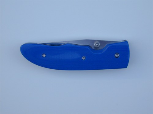

Hello,
I was just wondering if anyone could tell me what high polish G-10 looks like? Does it come out okay? I've really only seen G-10 bead blasted and was curious as to what it may look like buffed out.
Any help and/or pitures would be appreciated.
Thanks,
Jared
It looks great!, but be careful and wear a mask and use other protective stuff....: it is toxic, as I appreciate it.
I don't have a photo of it, but I made one for my maw-in-law, took it slowly through the grits to 2000, then buffed it, and it is so purdy I don't think she even uses it...just keeps it for show (it is a kitchen paring knife).
Like this:
A curved, polished G10 surface reveals the grain, which looks pretty cool. I used to have a Kershaw Random Task knife like this.
I just finished my first liner lock and used blue G10. I only sanded it to 400 grit and then buff with white rouge. It looks good.
