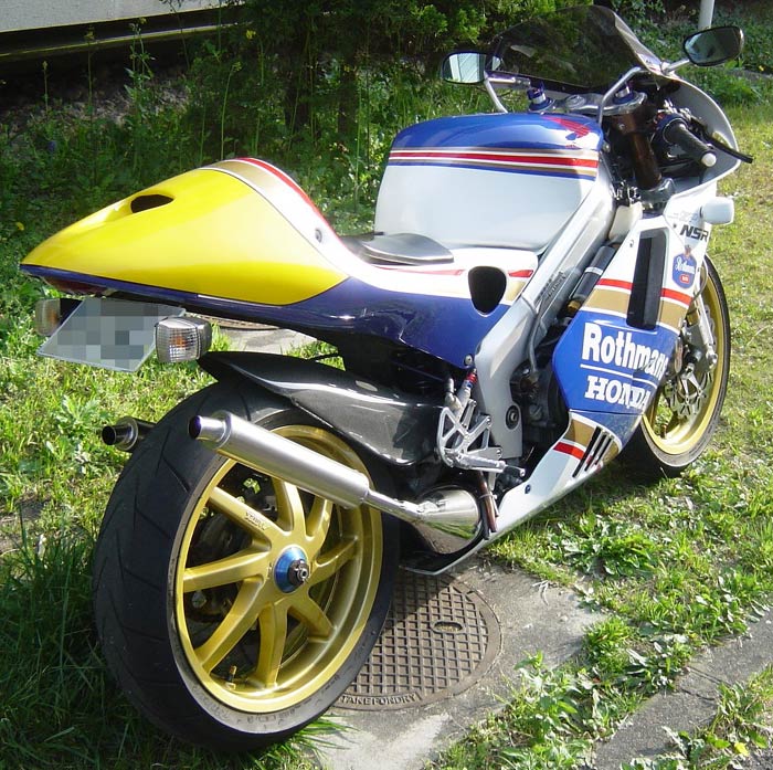

Let's use an analogy. You motorcylists with single-side rear swingarms will obviously note that you have a clip pin that you slip on after the center nut is torqued tight. That clip pin(safety) isn't some super rod that's going to make your hub area more tight. The nut is torqued tight for that. If for whatever reason it was not or had become loose, the clip is there to prevent your wheel from flying off and you hurdling down the tarmac.
Pic for my analogy:
