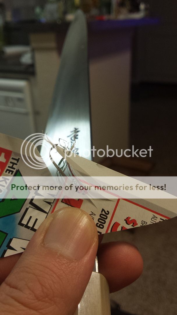

My yanagi has not even touched a stone under 4000 grit. I would NEVER want a yanagi 'toothy'. Mine is super polished and most competent sushi chefs usually polish their yanagi's.
When I see a chef steel their yanagi I cry inside. Even if Pyrex or ceramic.
If it won't whittle paper thinner than hair it's time to sharpen.
