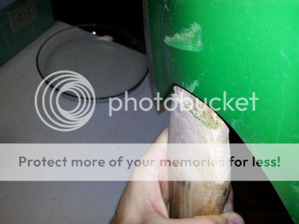

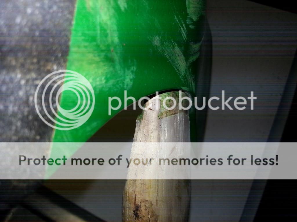

Anyway, this is how it now sits after a bit of use. Is this too far gone, or is it salvageable? How important is the shoulder underneath the head? If I needed to sand it down to re-fit the head, would that cause an issue?
It's a little bit hard to see here, but for some reason, this doofus took material off of one side only, so it the head isn't even on the shaft evenly...

But yeah a new handle is definitely in order.... That old one is all screwy. Wouldn't use it. I'd strip that paint, too.

I would redo/reuse that handle, I think, as long as there was a bit of shoulder/swell left when done. Love the paint job for some reason.
I'd try to use the handle that you've got. How does the rest of the handle look?
I would practice on the handle you have, if you can't fix it you will have learned things you can apply to the new handle.

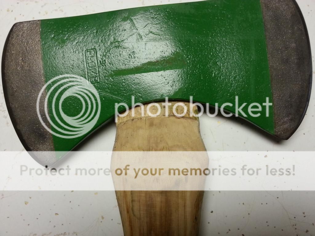

The current handle, in my inexperienced opinion, looks great, other than being poorly fitted. The ad said it was hickory, and he said it was oak when I showed up to buy. I'd imagine it's hickory.
This was before I used it.
I don't think the grain gets a whole lot straighter than this.
Get so Titebond III or Gorilla Glue or .... Square up the side that was butchered and glue a piece of wood in place. Then work at setting the head in place. I'd set the head a couple of inches lower. You should have some wood showing above the eye before you place the wedge in the kerf.

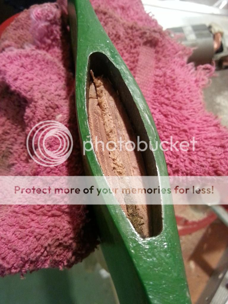

Looks to me like you've got a ton of shoulder left to drop that head down onto in order to find a nice tight spot. I'd like to see a shot of the wedge, but you'll likely have to cut the kerf/slot a bit lower then make yourself a new wedge. So long as he didn't use metal wedges it will be a simple matter of drilling the current wedge out, then pounding the handle out. If a metal wedge got involved it can be a little trickier when you want to save the handle.
Fortunately (or unfortunately, depending on your view, as it may have prevented this in the first place) he didn't use a metal wedge, and the wooden one started working out in short order. I'll see what I need to do after I get it apart. I'd think it wouldn't be too difficult to rip a new/deeper kerf on the tablesaw.

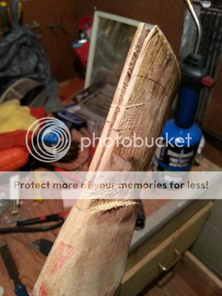

I used a chisel to remove the bit of wedge sticking up above the handle, after Bo T expressed concern about power tools. :p
Had to go back and drill many more holes... I have a new appreciation for how hard wood can wedge into small holes.

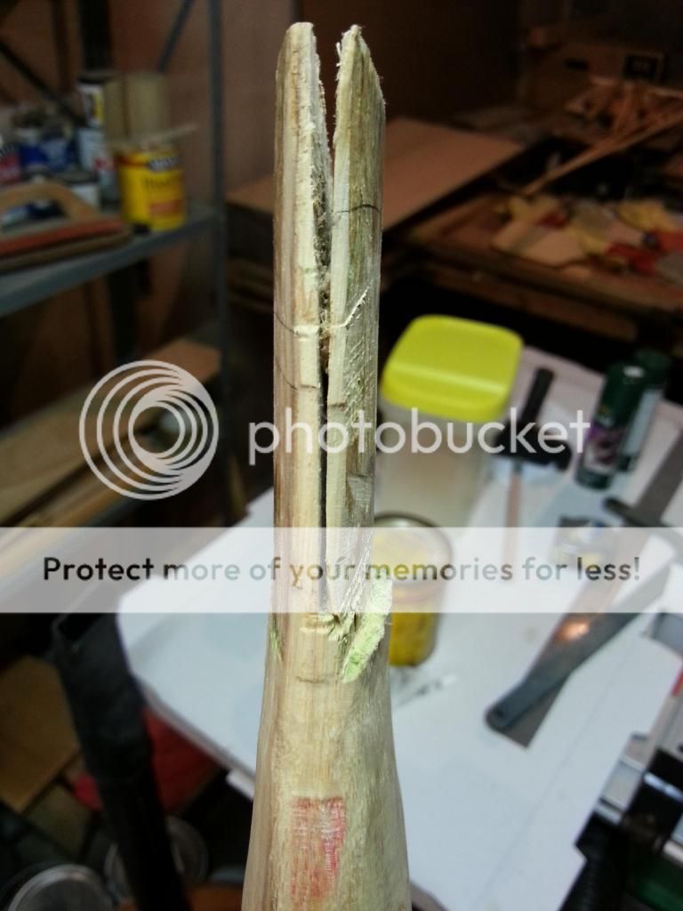

Now looking at it, I'm kind of concerned because it looks like since so much was removed from the one side, it's actually started to crack at the bottom of the kerf on the narrow side perpendicular to the grain, which seems like a big no-no. It was bowed in on the kerf pretty bad since the wedge only went down about 1/3 of the way, and you can see the hour glass figure of it still.
Is it still worth playing with this one?
Guess you could go either way but you sound leery and there isn't big money in a new stick, particularly since I was thinking you said you already ordered one. I think the peace of mind is probably more valuable than the handle, plus you could cut it up and use it to rehang a couple hammers or some other project. No biggie.
It was a poor hang. That huge shelf made by driving the head down would eventually rear its ugly head as a crack of some sort or another. Since I gather that is the side the previous owner was removing material from, it kinda makes me wonder if the handle is all lop sided or what - not real unusual today. Always tough to really tell in pics. Now, no good reason you couldn't hang it on that original handle just for the practice. Overcoming the problems would probably be an excellent learning experience. I have re-re-hung a couple of my own just because I can do it pretty fast now, and it really taught me how good my own work was. Then remove it and hang it on your new stick. I understand that this isn't an fun past time for some people like it is for me, so I certainly understand if it seems really pointless to hang it, then rip it back apart and do it again.

In all fairness it looks like 'doofus' only removed material on the one side so it would hang on a wall flat. Sweet axe though, like everyone else though I'd def strip that green off.
