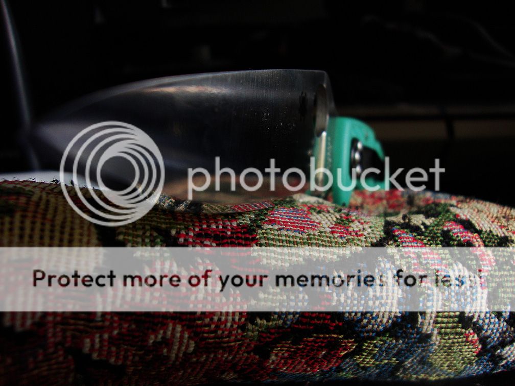

Im quite curious about the lowest edge you can put on a VG10 blade without losing too much stability and still holds up vs regular cardboard.
The reason im asking is because i own a Spydie Police3 which i convexed and thinned quite a lot using sandpaper and medium soft backing, im totally unable to measure the apex precisely but when i put sharpie on the edge and then do 2 passes at 30 deg on the sharpmaker i get a really tiny contact area leading me to believe it is around 25-27 degrees inclusive.
I had a few occurences of mild rolling when i disjointed a roast chicken but i have to admit i deliberately tried to dig in the bone to test the boundaries.
The performance of this blade is quite awesome as i can keep it shaving sharp for months with just a 6 microns diamond paste loaded balsa strop and the occasional steeling with a spyderco fine profile.
Keeping in mind i dont abuse this knife at all and it sees a lot of kitchen and soft to medium daily use, would you think i can still go thinner ?
Thanks for input ;)

Where was the contact area on the edge when you used the Sharpmaker? Did it reach the apex? Can you raise a burr at the 30-degree setting?
It sounds as if you've already found the correct angle for that particular use. But because you are freehand convexing the edge, we can't tell you how acute you can go in degrees per side because neither you nor we really know what kind of edge angle you have.
30 degrees inclusive will give you a pretty good edge on the Police. Because of the blade geometry, I don't think you would improve much by going more acute, but it would depend on what you're cutting. With soft meat you could go very acute, but not if you include bones.

Thanks for the answers guys, i probably wont go further as i feel it is a sweet spot and dont wanna risk losing too much stock.
To clarify, yes i hit the apex with a tiny spot when i did the sharpmaker + sharpie trick.
