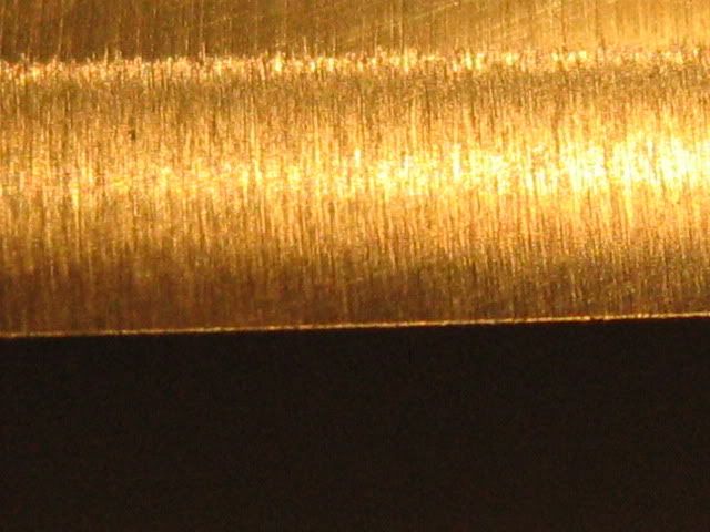

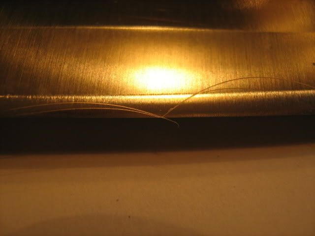

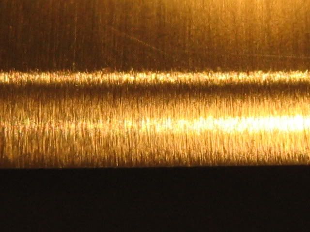

I don't do this for all knives, just ones that are used and abused a lot. For example my dad's ZDP endura sees so much abuse that using stones to keep it maintained takes more time than I have so this two step process work perfect. It could be sharper if I used one more belt between but its razor like as is and that's good enough for him. In years of sharpening I've learned that with some things quality is better than quantity such as in this case where the quality of the abrasive trumps the number of abrasives needed.
ZDP after 80 grit belt
After polish
Sharp too :)
Thats a pretty sweet lookin edge for 80 grit. I've done the same for my work knives with a 120 grit and white compound on leather.
