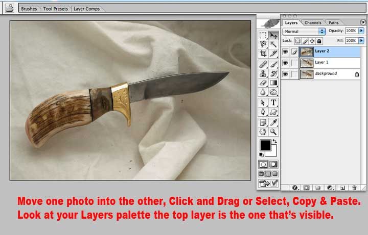

Duplicate the Background Layer by pressing Control + J, in case you need to rotate the background knife.
Move one photo into the other, Click and Drag or Select, Copy & Paste. Look at your Layers palette the top layer is the one that’s visible.

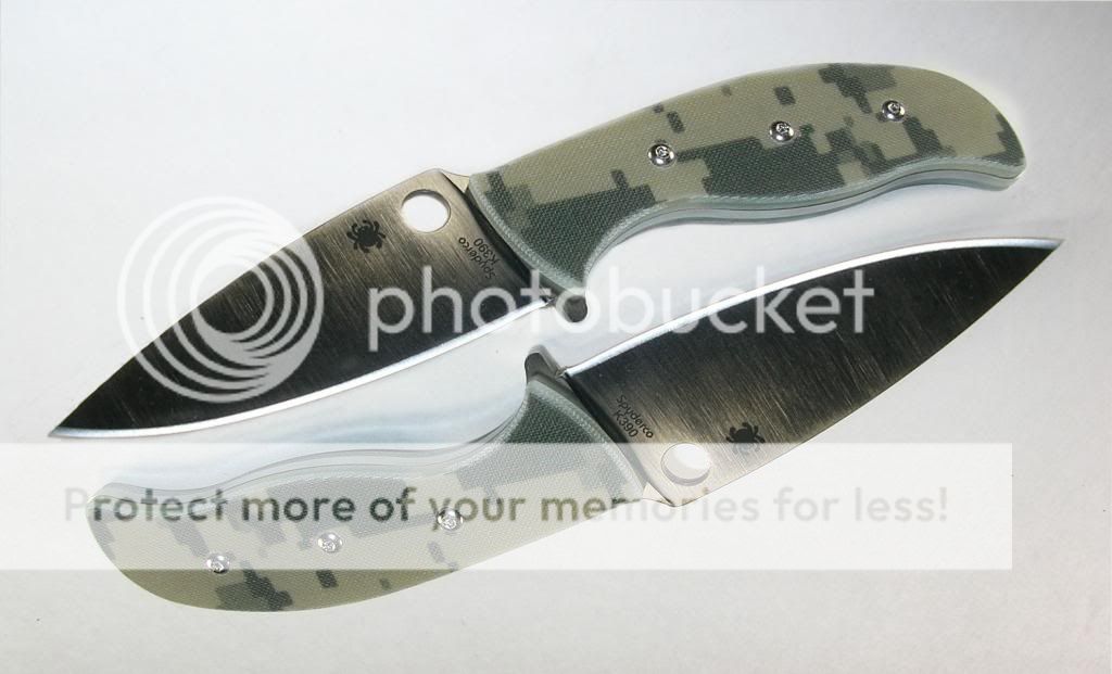

After a couple of hours of trial and error I finally got lucky and put in the background.
8 more years and I might learn something.:o
I did the tutorial to show you how to get two different views of the same knife in an image. It looks like you only want to show the same knife image only inverted.

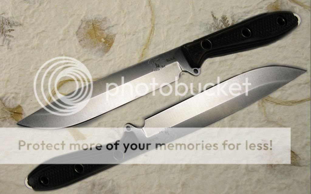

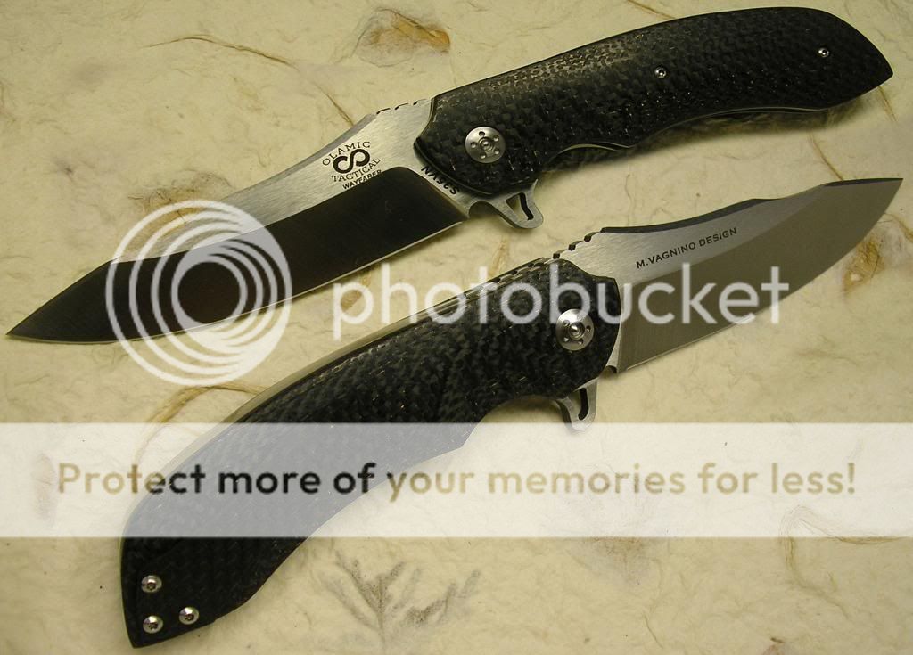

I've played around with this off and on for some time now. Not terribly complicated in principle ...... execution, however is hit or miss for me. As with most of the pictures I take, lighting control is the most difficult aspect and something with which I always struggle. This is even more true when taking these types of shots. Bracketing the exposures in each of the individual shots does seem to help .... but I lack the lighting set-up and patience. Thank goodness I don't have need for this type of shot for my knife "hobby" Here's the quick one I did after PhilL made the initial post:
As you can see, lighting could have been so much better.
Dennis, I think you have the technique nailed.
Of course it all starts with the photos.
I've never had your problem of having to bracket exposures to match the images later. They all need a minor tweak when you start off, but nothing major. The quick fix in Photoshop CS is Image menu > Adjustments > Match Color, and then just match the background image.

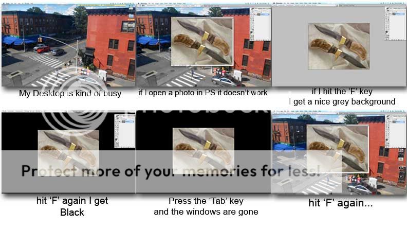

One of the things I know I never covered was ‘My Workspace’ in Photoshop. I try to keep it simple, usually I only have my Tools and Layers palettes open. I open History and Actions palettes only when I need them.
I never work with my ‘Desktop’ as my workspace, it’s too busy and doesn’t allow me to do certain Transformations.
Here’s my Quick Tip on the ‘F’ key.
