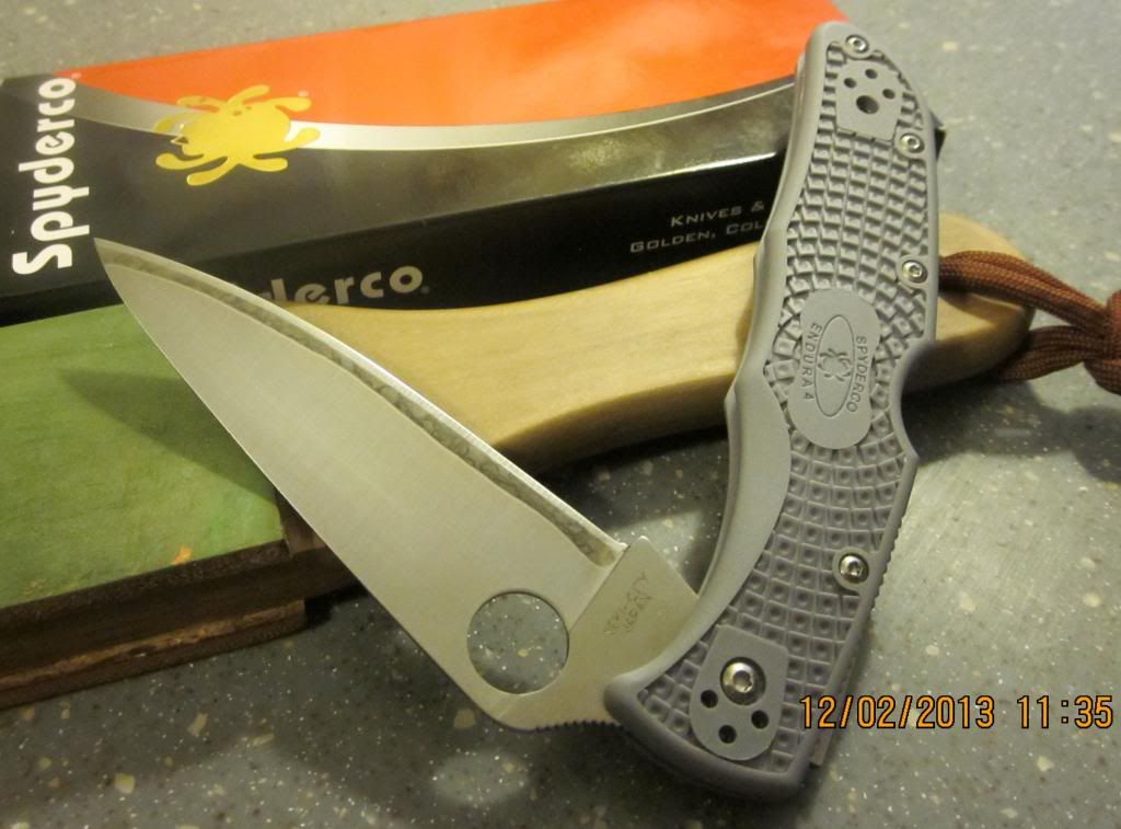

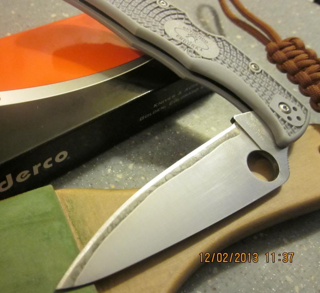

I achieved this patina on my Aogami Superblue Spyderco Caly 3.5 with about 35 minutes in distilled white vinegar. And I'd always advise you do not let the acid touch anything but the blade.

I noticed that, increasing the temperature of the vinegar will speed up the process. I didn't leave the knives submerged long. Only 20 min or so. I don't think the penetration was deep though. After use, some of the patina rubs off. However, I like the primitive used look. I can always do it again next month.
