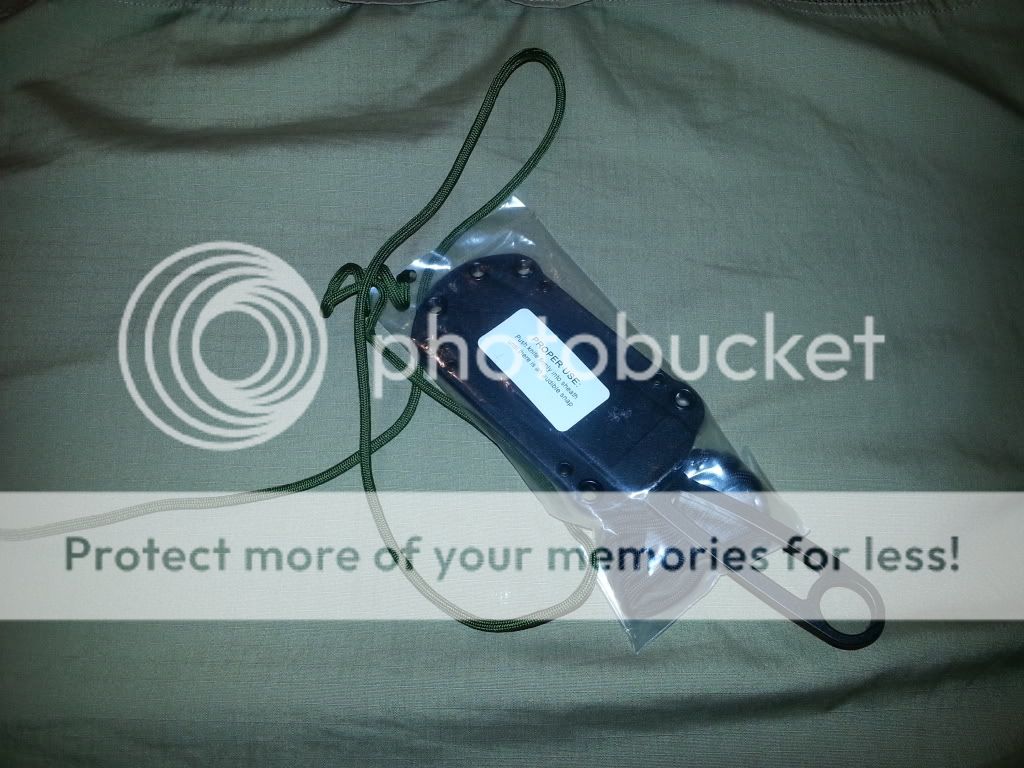

Ok, I got no less than a dozen emails from folks wanting to know how I wrap my 14/24's.
It ain't magic, its just paracord, and real easy. I found this one that I liked in the ESEE forum. I done a search on Izula handle wrap, and lo and behold, up pops a ton of stuff.
Anyhoo, I wanted to post up something to get ya'll started.
First things first, TAPE UP THE BLADE!!!!!!!!!
I cannot emphasize this enough, tape up the damn blade. You may feel like you don't need to, don't want to, etc.......whatever. Tape up the blade or you WILL GET CUT!!!! Every BK14/24/Izula bite I have ever seen, came from wrapping the handle. TAPE UP THE BLADE!!!!!!
That said, I didn't tape mine up, because I wasn't actually wrapping the handle, but you better bet your ass when I do one for reals, I tapes up the blade. You do the same. There will be some joker that thinks I'm BSN ya'll about this, and he'll get cut. Just the way it is.
Ok, you're gonna need some paracord and a knife to wrap.
Check.

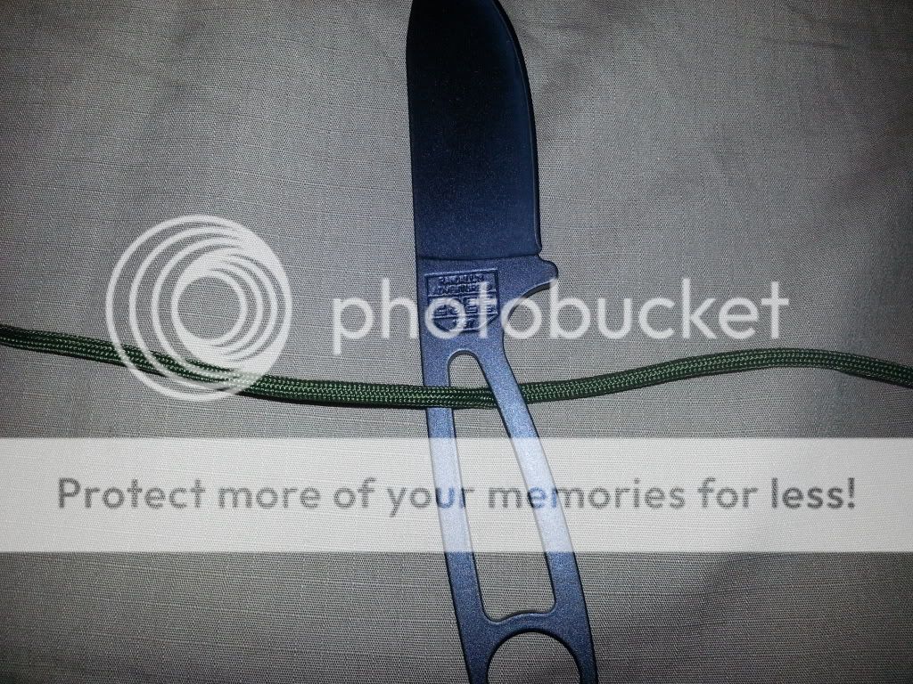

On your Eskabar/D'eskabar, make sure the ESEE is facing up. It doesn't really matter, but it helps you work from the same side, so all your knots line up symmetrically. Pass the paracord under the right stem, and over the left stem.

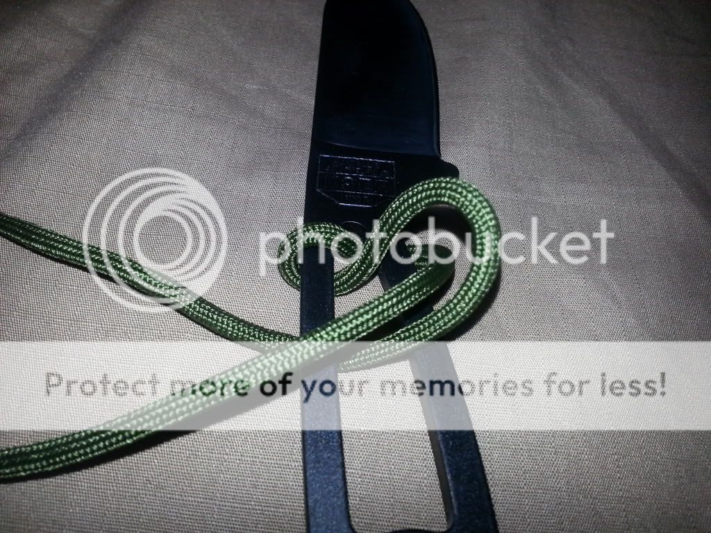

Then, take the cord that went over the left stem, and pass it under the left stem, making a loop.

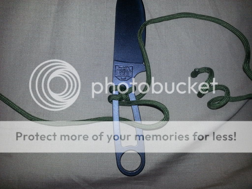

Pass the cord that went under the right stem, through the loop and over the left stem.

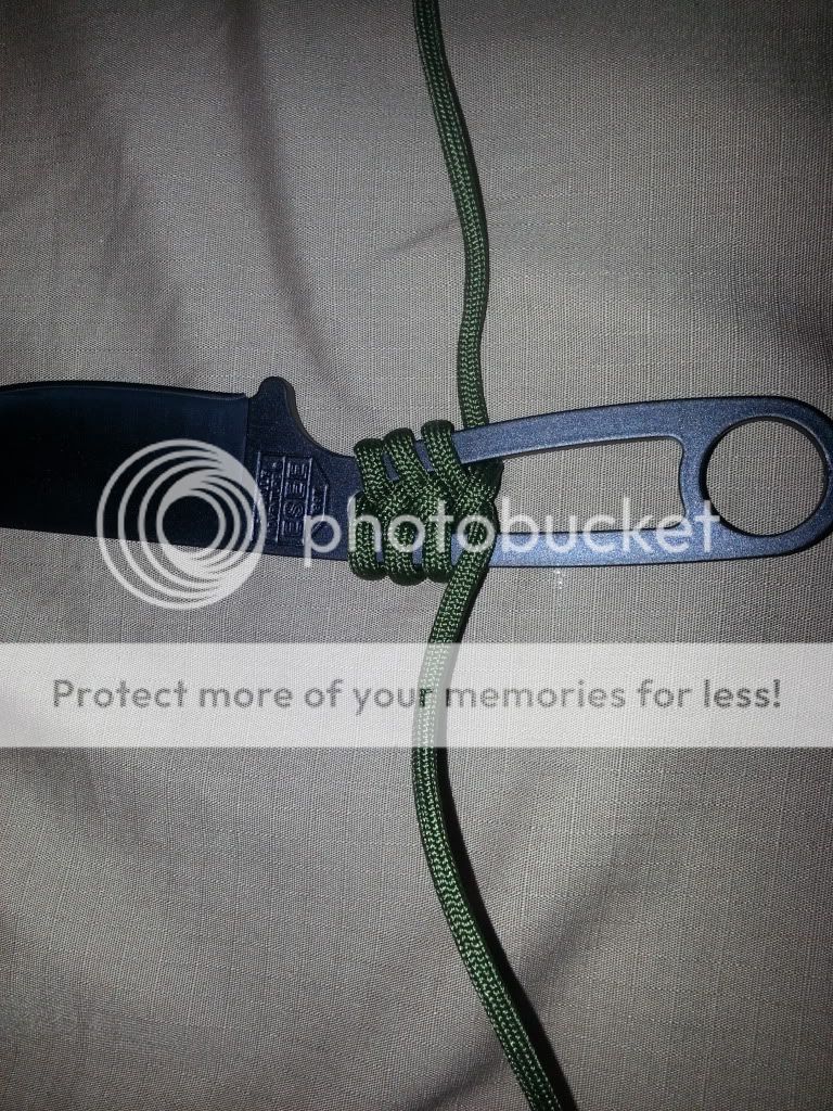

What was once passing over the left stem, is now passing under the right stem, and vice versa. You will want to pull it tight, as tight as you can get it, and push it up towards the blade. It won't hold for long, so, once you start, you gotta keep going. You don't get the chance to come back and tighten anything up, so, make sure it is as tight as you can get it, and centered in the opening.

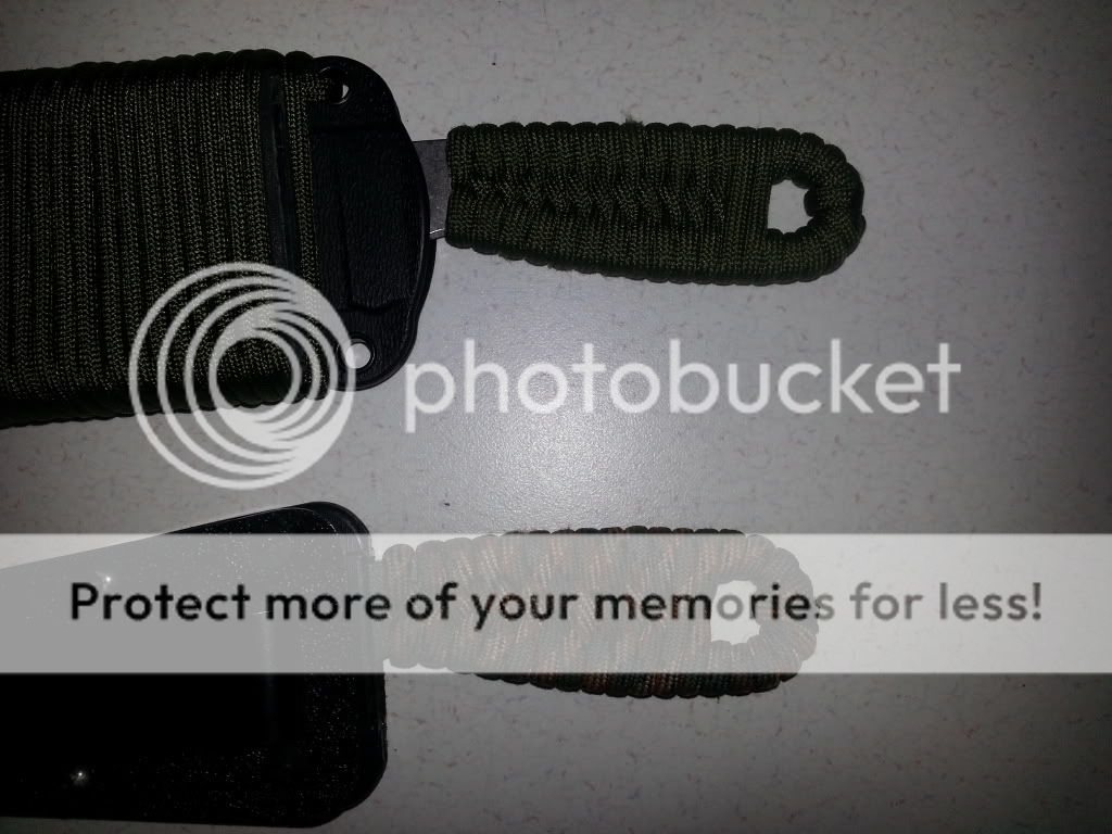

Repeat over and over again, until you fill up the void. You can get 11 knots in the web of a BK14/24 and 10 in the web of an Izula. If you keep everything tight and pushed up, you are still gonna work your ass off to get that 11th or 10th knot in there, but it can be done by pulling the paracord tight.
The rest should be pretty self explanatory, but ya'll are still having trouble, then I'll do a full wrap on video so you can see what's up.
