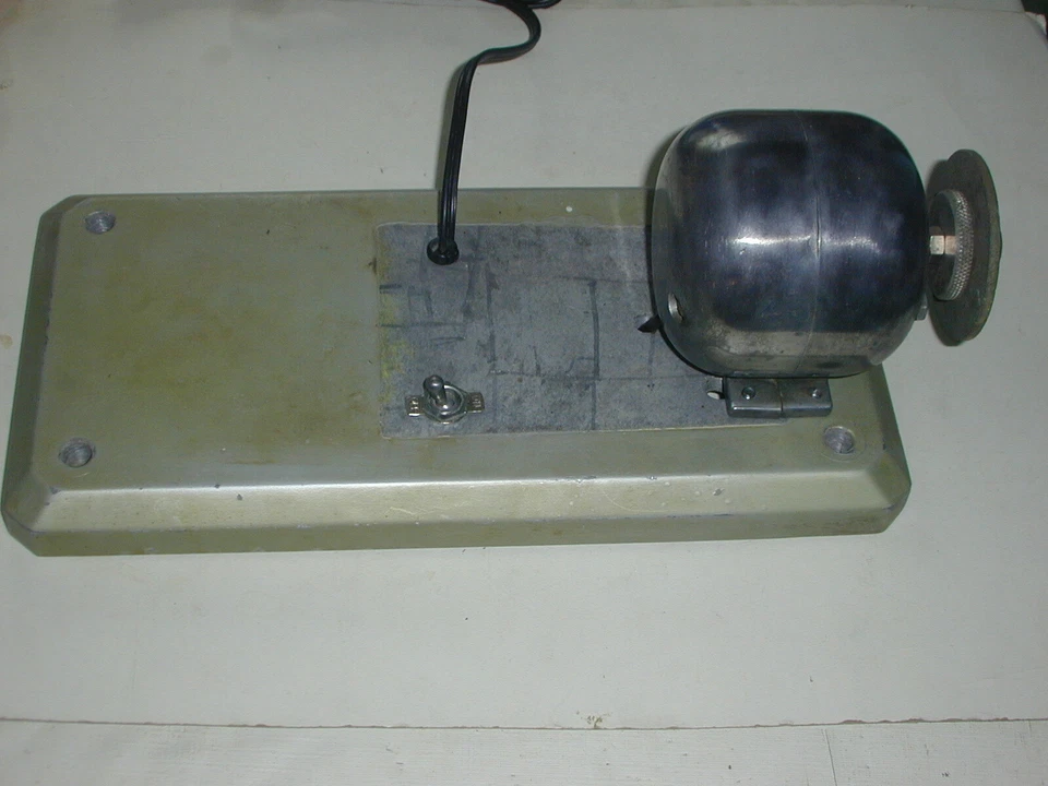

The tool for the job is a small motor with a wheel attached. You can easily make one with a 1/4HP motor and a shaft adapter for the grinding wheel. Look this up on eBay and you will see something similar to what I am talking about:
Vintage Small Bench Grinder / Lathe for jewelry, metal working, hobby​
image link - https://i.ebayimg.com/images/g/Wf8AAOSwuSJiZZaN/s-l960.webp
