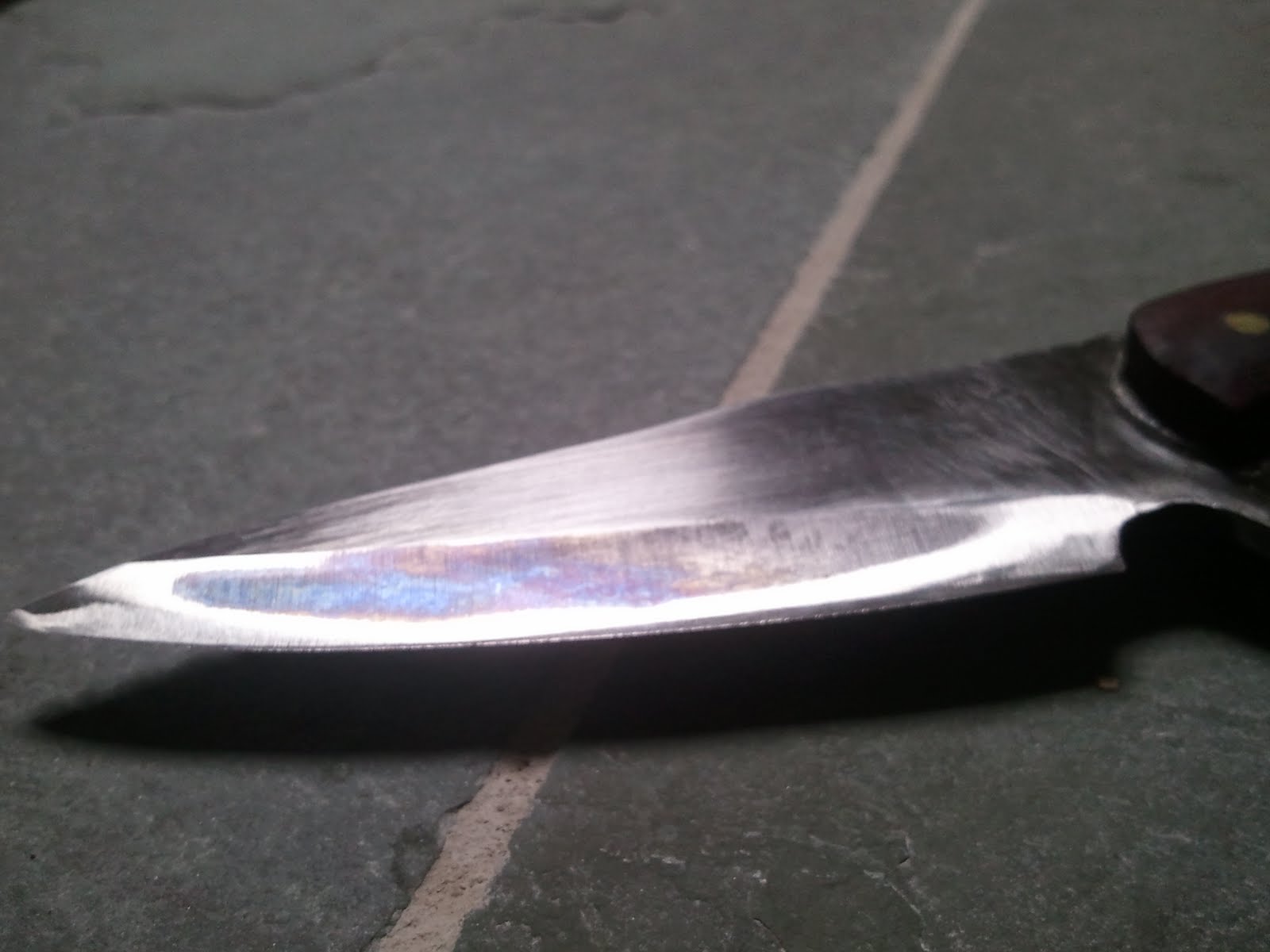

http://4.bp.blogspot.com/-3xdafhVXGV8/TicXkVyl3gI/AAAAAAAABOs/E4hMlvi2gzE/s1600/grind+on+Kpod2.jpg
http://1.bp.blogspot.com/-8pjqfQZRevk/TicXkDMLJ8I/AAAAAAAABOk/sC6T_GoC-Sk/s1600/grind+on+Kpod1.jpg
These pictures illustrate my dilemma- how do you get an even thickness at the edge, when the top grind line that determines the plane of the grind isn't parallel with the edge?
I left the discoloration from heat treating on this one to show what the difference in edge thickness does when you put the sharpening bevel in.
The Randalls look like they have nice, even thickness at the edge, and what I'm trying to figure out is, how did they accomplish that? By changing the plane of grinding along the blade, or what?
It looks like you have ground the blade parallel to whatever grinder you used. Instead, it looks like the tip should be pointing to the floor. This would work best on a 2" belt sander/grinder. What did you use to grind with?
It also lookes like you took the temper out of the steel. What kind of steel did you use and what was your heat treat methods?
Jason
Yep, grind is parallel to grinder, that's the look I wanted to achieve- done on a 2/72" belt sander.
The discoloration is from the heat treat, I didn't remove all of the oxidisation. (see previous post)
The question I have is, how does Randall get a consistent thickness at the edge, when the upper grind line isn't parallel to the edge?
440c, tempered at 385f

Perhaps, but remember that Bill Moran rough ground on a large emery wheel and did some of his finer grinding vertically on a 4 inch wheel and did the full convex freehand without using a slack belt. I have his video and I don't recall him using a platen in it. Charles Ochs rough grinds vertically on a 3 or 4 inch Bader wheel and cleans up on a disk sander. Wheels do not always equal hollow ground.;)

you set your edge 1st . Then you work the top grind line to where you want it and blend all lines .
