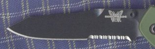

After six months of being my "using knife" the BT2 coating on my BM940SBT is still in great shape. Up close there are parallel rows of surface scratches, especially over the serrated portion of the blade. There are a few light scratches at the tip. None of them go all the way through the coating and the knife does not look "beat up". Here is a picture.
