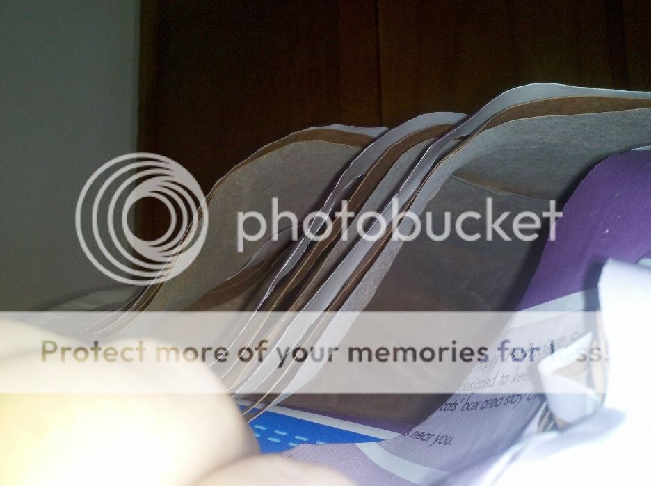

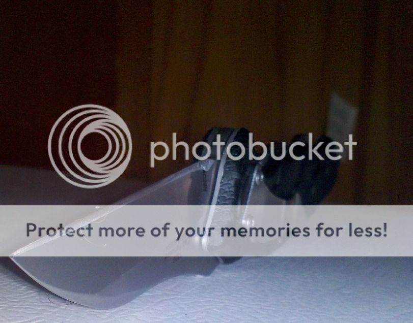

So long story short, I cut open the bag across the top and my edge was still hair whittling. I'm using a Kershaw Needs work with 14C28N, finished on a 600 grit DMT hone and stropped on CrO coated MDF. I'm not going to make any direct comparisons to what was shown in the videos I mentioned, but I will say my results definitely disprove the idea that just "one" cut will remove hair whittling sharpness. So I continued on making cuts until the knife would just barely whittle hair in the last picture you see--by this point I had to hold it very close to my finger tips and really fight it to whittle, so I called it then.
Here is the knife, and the bag, after 20 cuts into the paper. The cuts were performed by plunging in with the tip, and gradually moving upward to make sure that every portion of the blade aided in each cut.
Just barely whittling still, but still plenty sharp enough to pop hairs off my arm.
And here's a picture of the bag material... Each side is actually three layers of this cardboard paper material, and the inside layer is coated with a fine powder of clay dust (that white shade you see on the inside layer of cardboard).
