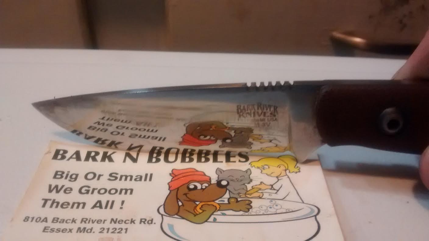

Just got in 400/800/3000 Naniwa Choseras. I know not to let them soak long, and can be used splash and go. I read on another forum that is says (in Japanese) on the box to soak for 20-30 minutes. How long do you guys let them soak, if at all?
Thanks
Just wanted to add, I have never gotten my Necker 2 as sharp as now with these stones! I mainly let them soak for 5 minutes or so, then went at it. I wasn't even really trying to polish but that 3000 stone really did it up!
