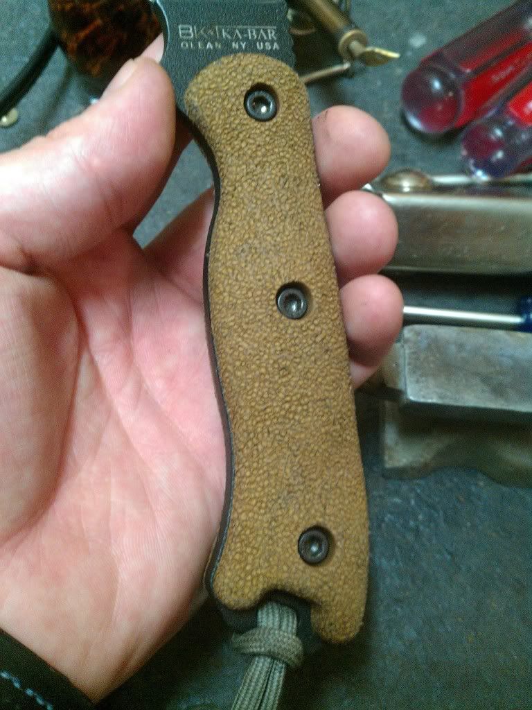

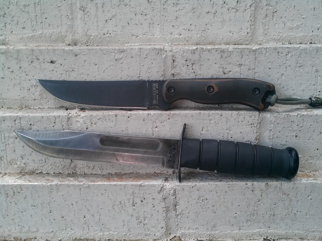

Dying the scales is a fun, quick little project. I experimented with it a while back with my brown 15 scales. First thing was try a light dye job used dark/forest brown or something if I remember. When dying scales you are kinda "mixing" colors plus the longer you leave them in the dye the darker the color, so brown+dark green= muddy dark brown. As DerekH said someone used a light or bright green and it turned out a lot better. Plus the dye is barely skin deep, so bumps, dings, scratches, etc are going to show the under color. Its kinda interesting, anyways...
First round dying....
Dark green+brown scale+short dye time=
Next this scale was left in the dye a lot longer, then it was aged/scuffed. Dark green almost black with brown showing through.
Then as an experiment I stripped away the dye using paint stripper. Was a neat experiment cause I found out you can some what reverse the dying with paint stripper. Also stippled the scales.
Then they got rubberized...
Then I painted them a couple times, and a bunch of other stuff, hard coated them with 2 ton, and put some liners on.
Kinda funny to think those started out life as just the plain jane brown scales, lol they have been through a lot.
