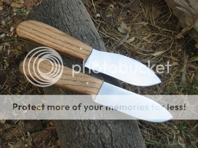

It depends on the patina. If it's a very light forced patina, fingerprints will rust right through it. The most protective patina is a natural patina formed over time from regular use. The following is a pic from BF member bearthedog. Look at the Nessmuk in the bottom. That is not/not heat treat scaling. That is a natural patina formed over time with regular use, and if you check out his travel threads (where he takes his knives all over the world into the dessert, jungle, mountains, etc.), you will see how much he uses his knives. But basically, this kind of patina is very protective. I'd say all he probably has to do is wipe the blade down after use and it probably is pretty corrosion resistant, despite being made of O1 (I think).
Pic by bearthedog
EDIT: Here's the original knife! Pic by bearthedog
