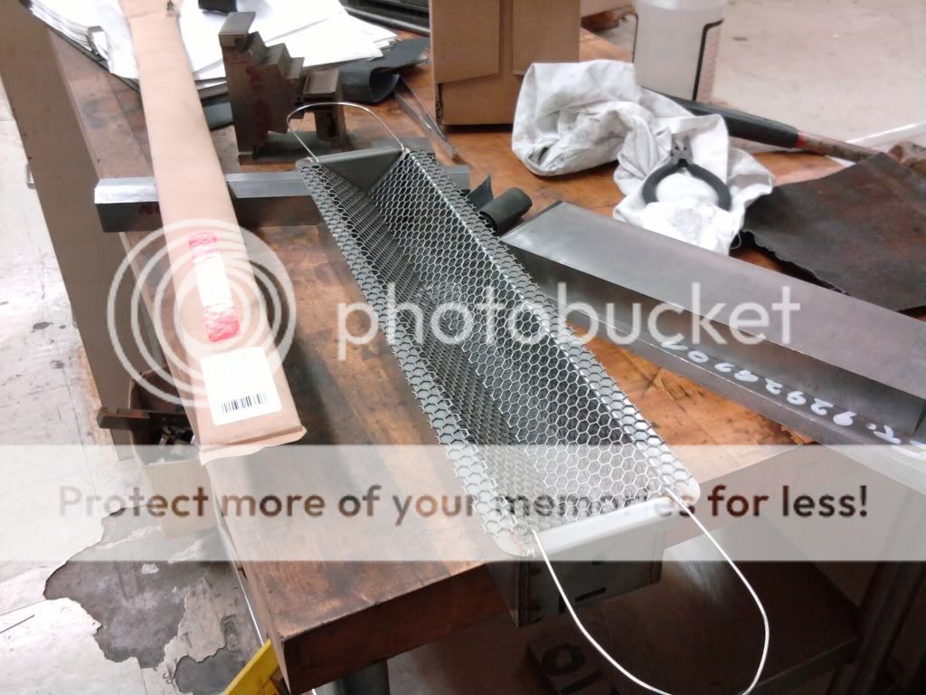

I like my setup, but it is NOT suitable for edge quenching. My tank is deep not wide.
I am curious about the edge quenching. Where can I find more info on this? I saw a video series posted on here with a guy doing what I think is edge quenching. What are the pros/cons to this?
I made this to edge quench but can no longer find information on edge quenching.
