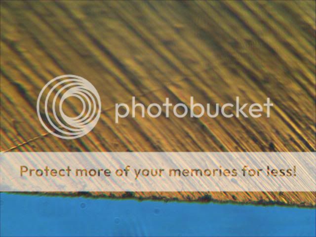

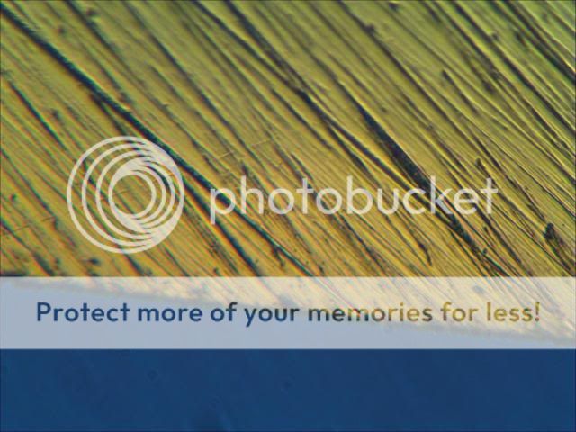

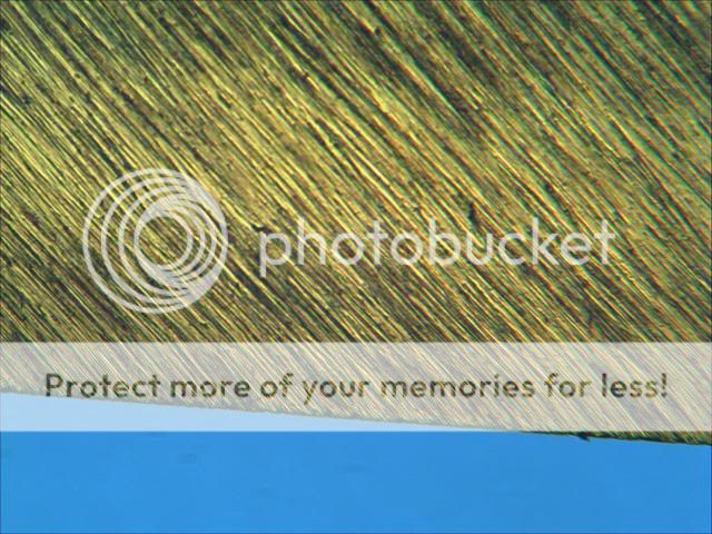

Here's a few pics that I thought might be an interesting add to the thread. The first is at 160x, the second at 640x prior to stropping, the third is after about ten passes/side on some AlumOx stropping compound. You can clearly see a few things, how quickly the perpendicular scratch is being erased from the bevel - scratch is from the Kydex sheath (I should get a leather one for it) and wasn't visible at all to the naked eye. For reference the focal depth is less than the depth of a grind scratch and a human hair takes up nearly half of the image area at 640x. Another is the pit at lower right from a piece of loose grit impacting into a grind trough - the crater is much reduced in the second shot and slowly disappearing - can also clearly see how some of the debris and "micro chipping" along the edge are disappearing as well. I gave it another dozen or so passes on the strop after the second pic but didn't take another shot because the "reference" scratch was completely gone by then and I couldn't find the same spot on the the bevel - which continued to show a reduction in depth at the apex. Knife is 1095, stone is a King 6000 grit waterstone. This edge can just tree-top leg hair after raising and removing the burr twice and stropping 20 or so times.
