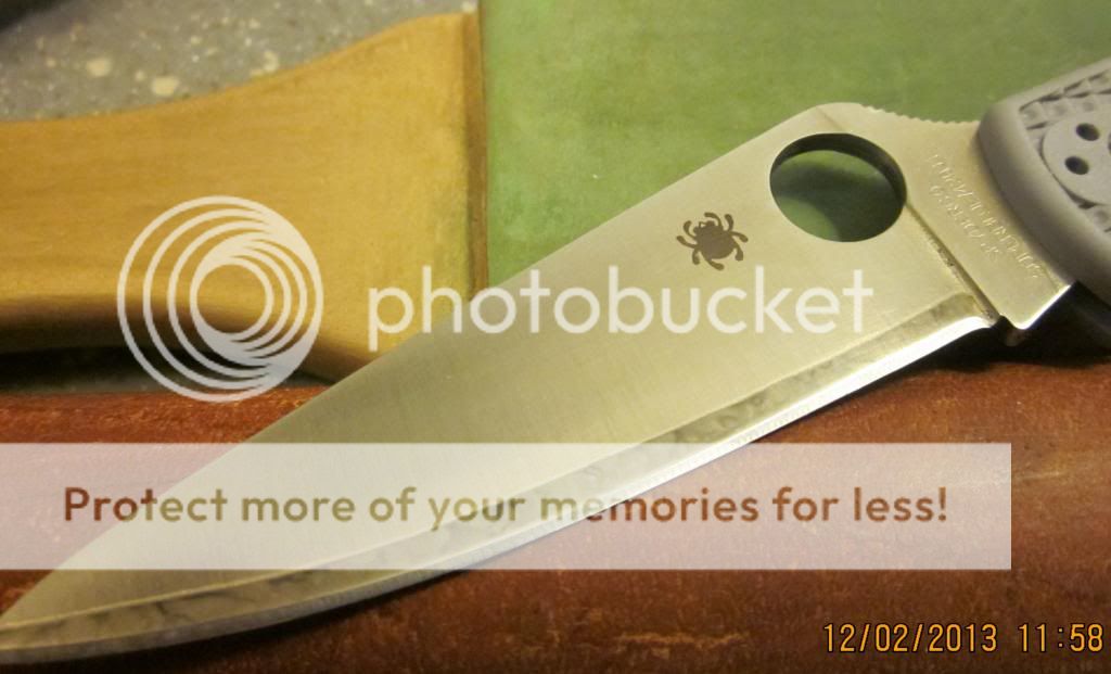

Here is my Stretch. The patina on the laminate is hard to see in this pic, but very noticeable in person. You can also see the scratching that the FRN makes.
