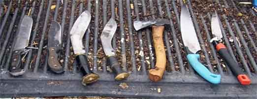

That is the first bunch of blades used on this :
and :

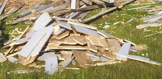

were used on this :
As I relaxed into the correct technique I found I was approaching the same speed with the Ang Khola as with the Ratweiler. You just have to use different muscles. The khukuri was also taking about half as many hits. There is a bunch of heavier wood in the background, I'll cut that up tomorrow. I should be back into sensible technique by then.

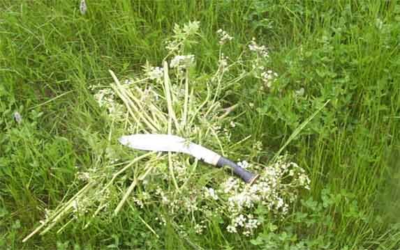

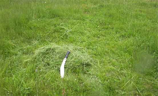

I like the balance and general heft of the 18" Ang Khola for wood work, for lighter stuff like cutting grasses :
It does ok in terms of cutting ability. The edge hooks well, nice length, but all that power is wasted and it is the kind of thing you do more for a wrist workout than efficient cutting.
As the vegetation gets heavier then the knife gets more effective as a cutting tool, but even on some thick weeds which are a fraction of an inch wide the khukuri is still way too much power :

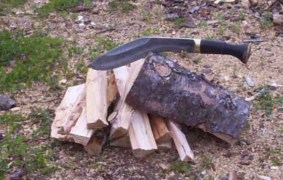

You have to hold back on the swing because it ignores the weeds and isn't slowed down at all. The khukuri excells on thicker wood work, it easily takes apart a small round :

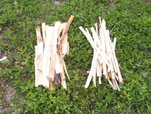

and has no trouble popping the splits into very fine sections :
For the small splits it is again overkill in terms of power but the actual amount of physical effort it takes is only a small fraction of the limbing and bucking so I don't view it as much of a functional negative.
