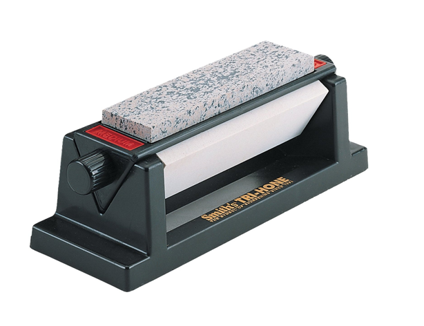

I've been haunting this corner of the forum a lot lately, so please bear with me! I have a honing set up of the Smith's Tri-hone (coarse, medium (600 grit), and fine stone (1000 grit))...

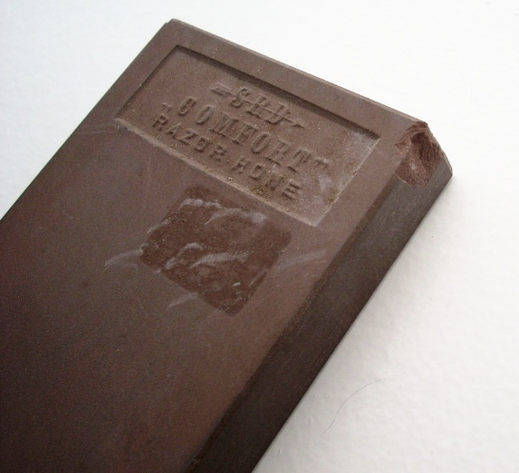

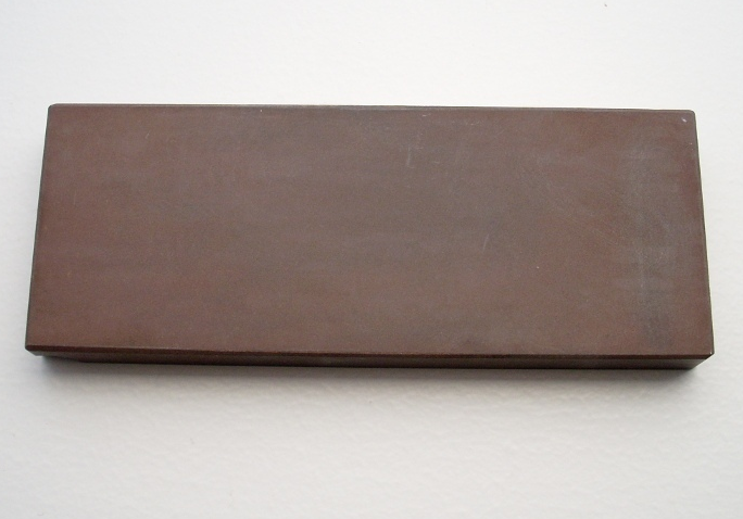

and a barber's hone
Are these stones sufficient for razor sharpening, or do I need more?
Also, I have an Illinois Strop coming from the 'bay that looks to be in decent shape, but how do I know when to move from the stones to the strop? I can shave arm hair (with some scraping), but what is the test to know when to move to the linen and then the leather? Thanks in advance!
-Matt-
Going from a 1000 grit to a barbers hone will take a long time to be able to put a shaving edge on a razor. The usual progression is something like 600 grit (for setting the bevel), a Norton 4k/8k, then a 12k stone, before going to the linen or leather. A barbers hone is usually used to maintain an edge, not obtain one.
Dole, Your stones are just fine and with the Illinois stop your getting you'll be set up well. Take your razor to the 600g stone (I'm hoping the bevel is set) for 20-30 passes on each side, then the same on the next finer stone, then the Barbers hone and the same amount on the strop. By then your razor should be ready for shaving. Maintain your razor by stropping only after each shave the same 20-30 strokes on each side. You may go like this for months until you notice the stropping alone does not have your razor shave ready. Then go to the Barbers hone for some work and back to the strop. Keep working at it as there is a learning curve. Good luck, DM

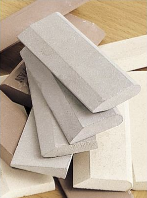

There is a HUGE difference between the legs and face! Out of curiosity, would a set up like this make my honing any quicker/better?
It's a set of "four each of 1000, 4000 and 8000 grit Japanese water slipstones." Dimensions 2-1/2" x 1" x 1/4" Or are these two small? Thanks again everyone for your continued help!
-Matt-
I think they are way too small. By the time you're starting to abrade the surface, the razor will slip off and get dinged. I use the full size Nortons, and sometimes wish they were bigger...

The barber's hone you have is probably somewhere in the 6-10k grit neighborhood. If you are already shaving leg/arm hair, you do not need to spend any more time on the 1k, it will be counterproductive. With more time on the barber hone you should be fine, as they generally are fast cutters. The barber hone will be sufficient to touch up your blade as well after you've used it for a while, maybe 6 strokes per side to refresh the edge.
