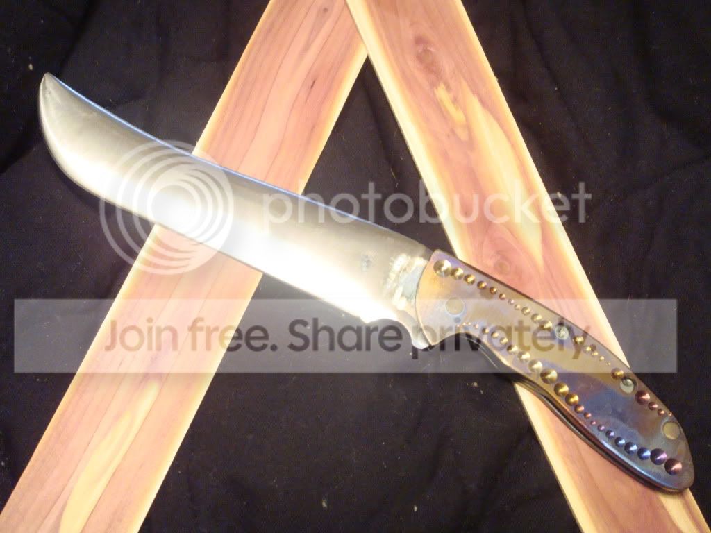

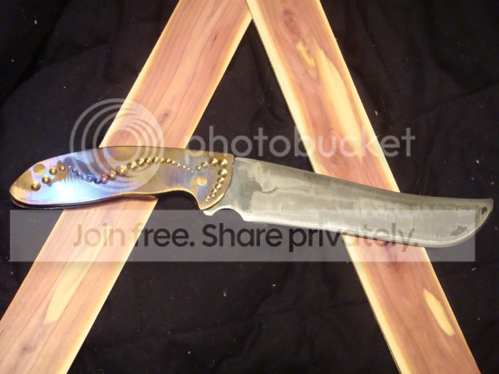

I've got my blade pretty much to the shape I want it, but I'm having a bit of trouble polishing it up pretty and making everything look totally even. Any tips? There's just a bit of slag left over from the heat treat that I can't seem to get off. Anyone know how to remove that last little bit of carbon?
When you find out, let me know about the last little bit of carbon. 12 hours with vinegar didn't work. Although I may not be using the right kind of vinegar. Is it Ti scales? Heat colored or anodized?
The blade should have been hand sanded and polished before the handles were installed.
That's Ti heat anodized. The pins haven't been made into rivits yet so I can remove the scales. I'd prefer not to have to hand sand that thing tho, I don't particularly think it's a durable finish and it shows scratches too easily. This is a work knife, I think I might just hit it with the orbital sander and see how she comes out. It'll give it a faux stonewash finsih
you're not even through the decarb layer yet, take it apart, finish grinding and sanding your blade, then reassemble and sharpen, there are no short cuts, sorry dude

Yeah I figured that, I'll take it down tomorrow and finish it up the right way. Like you said, no shortcuts in this business lol.
You will most likely find a bit of a depression where the carbon scale is.
Fresh belt!!!
Show us the tang, please. You might want to try electric anodizing. After building one, I watched a youtube of a guy building one with 9v batteries and borax. Simple google search for "9v titanium anodize" brings up plenty of results. What they don't explain on most of them is that the number of batteries changes the color.
Right, I've tried out anodizing the Ti using Coke and Lime juice and just giving it about 20 volts on a power supply. It worked alright but didn't get quite the color I wanted. The color is actually a lot more brilliant in person than the pictures, the light is somewhat overexposed. I'm pulling the knife down as we speak tho to go over it with the final anodizing job.
