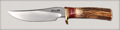

How strong are epoxied stick tangs

I am wondering about the long term durability of knives with stick tangs that are just epoxied on. I see a lot of hunting knives with a of stag and no butt cap or pins and am always worried they will eventually come loose, especially with a natural material like stag or wood.

How about on a Randall?
Randall claims to have not had a serious epoxy failure, and they've been comfortable not center pinning since the late 60's or so.
And as mentioned, there are many 1000's of knives that used various forms of cutler's rosin that are still rock solid. Frankly, I'd be more concerned about handle material failure in terms of splitting, rather than an epoxy failure.

Regarding the shorter tang shown above, it is perfectly adequate and handle will break, first. The tang takes almost all forces acting upon it about an inch behind guard. No matter what blow, it is where the hand tries to drive through handle at axis of rotation...or knife bend back over hand...same thing. Any extra length adds no strength, but DOES add extra adhesive surface area. In the industry, epoxy is considered a mechanical fastener, every bit as much as a bolt, screw, rivet or pin. It is not suited for high heat, solvents, etc, as any fastener has limitations of application.
