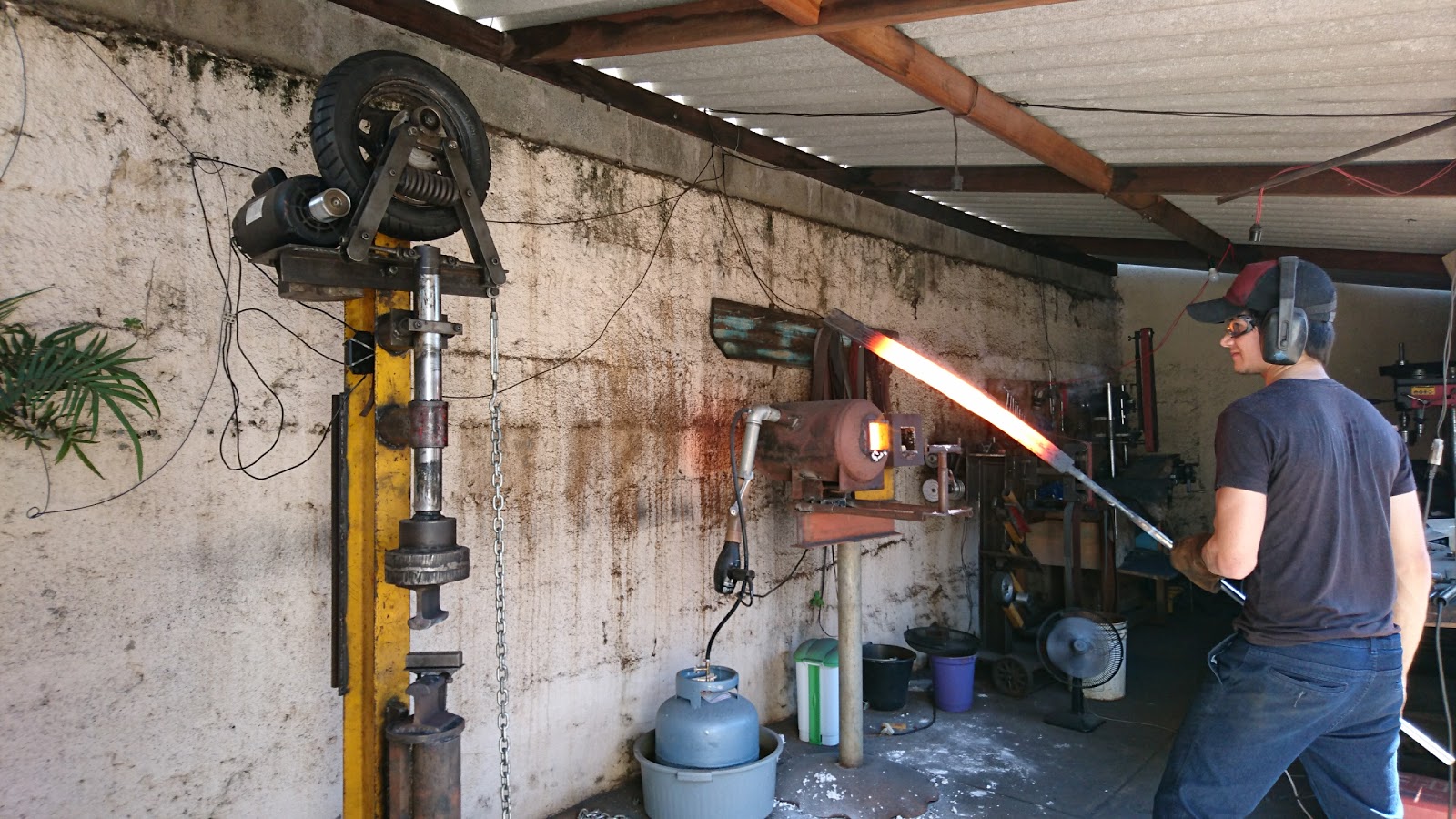

Here is some photos of the process..

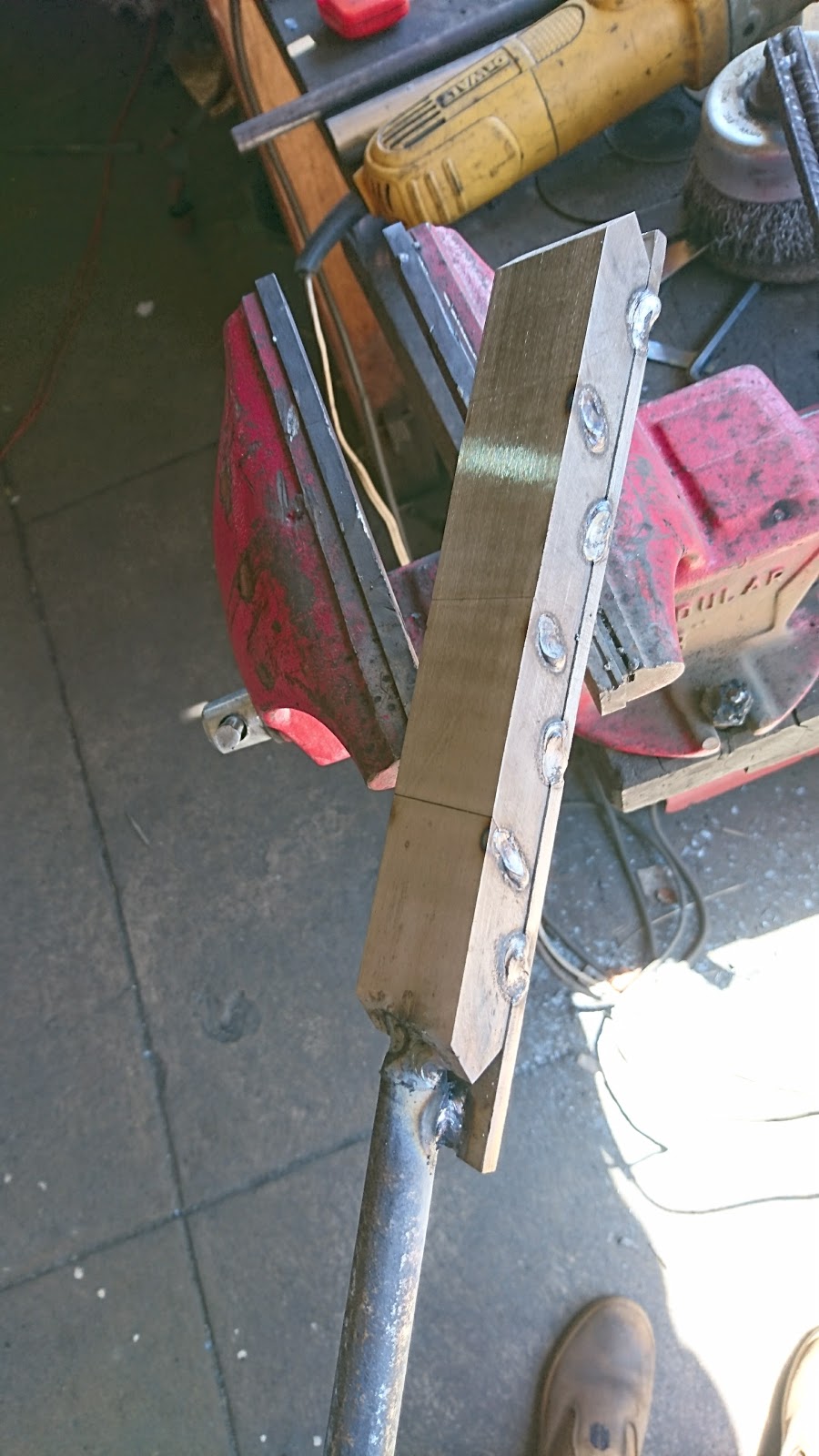

This is a photo of the called ferry flip..
The pattern was formed on the end of the billet, if I just forged down it will look like just a bunch of lines, so is necessary to cut like that in pieces of 45 degree angles, and forged welded to achieve the size of a blade, so now the pattern is shown on the surface of the blade.
The following picture is from the massive billet of the Yatagan, it was 25" long.
Here I'm forge welding it..

Great pics there. I really enjoy that you're doing this caliber of work in a shop you've obviously cobbled together out of what you could find with a lot of hard work, not a state-of-the-art facility packed with all the machines money can buy. I think it illustrates well that what really matters is drive and focus rather than having a bunch of toys.
Also I like that you refer to the flip as the "Filicietti" which I may do as well, considering that he was doing that way back to conserve steel when most guys were accordioning billets still. Love that guy's knives.
Thanks for the glimpse at the billets there, they look as clean as I'd have supposed. Tight twists.

Thank you Salem. I basically did almost all of my equipment, and what you see in the pictures is all I have, my shop is in the back of a rental house that has only single phase energy, haha, but I'm proud of it, and slowly I intend to invest in it, not in many tools but a place I can call mine and just enough tools that will allow me to do this for life.

Super cool, and great work, truly. *Hey* what's wrong with 1-phase? :D Hat's off to your endeavor, I don't think you'll have trouble doing this for life!
