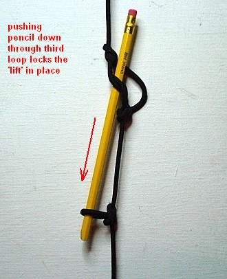

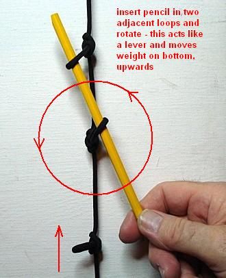

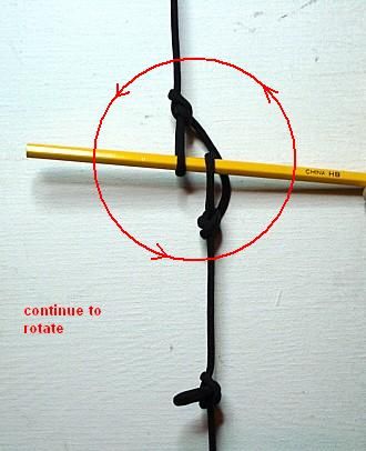

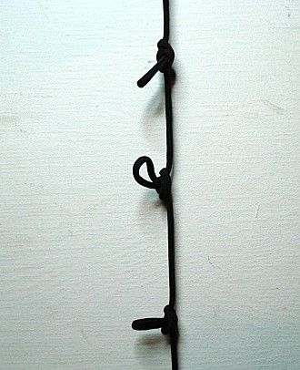

As some of you know by previous threads, I have a real penchant for toggled knots and any other cordage/stick combination. The more I play with them, the more possibilities emerge. One of these possibilities was a technique for shortening a line, seen below. I started with a length of 550 with multiple loops tied. Then, by inserting a stick (pencil in this case), the hanging length can be raised, which shortens the overall length of the cord. The stick can then be inserted in a third loop which locks in the shortening of the cord. OK, so it works, but the problem is, I just don’t know how useful this can be. But I kept thinking about it.

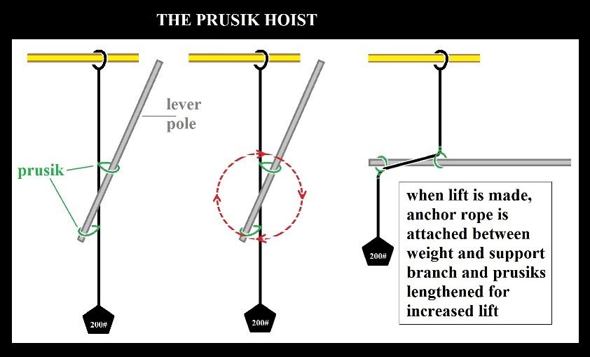

So a few weeks ago, an idea emerged. Can this technique be used for mechanical advantage in lifting something? A lot of us have seen Mors Kochanski’s Flip Flop Winch – an excellent tool for laterally moving heavy weight (if not, it can be seen here ). He also mentions The Finnish Windlass and the Spanish Windlass in his little booklet called, “Top Seven Bush Knots And The Use Of The Windlass”. Both used in a lateral fashion, at least in the booklet.
But I wanted to see if incorporating some of the stick and cordage idea above, would give a vertical lift with a mechanical advantage, so this past weekend, a couple of buddies and myself went out in the woods to try it out. The result:
[video=youtube;KvIK5PD2quw]https://www.youtube.com/watch?v=KvIK5PD2quw&feature=player_detailpage [/video]
Unfortunately this video is not as clear as I would have liked, so I’ve whipped up a drawing that hopefully better defines it.
In the video, we used a carabiner and a Prusik for the upper anchor point, although the carabiner isn't necessary if you have a branch to line the rope over.
In any case, it met and surpassed my expectations. So, I think this is pretty cool, but maybe it’s just me. ???? Any comments or questions welcomed.

Pretty cool way to gain a mechanical advantage. I used a similar technique to tighten stretched barbed wire fences.
A good idea. I've always liked levers. Maybe as much as I like knives. I can see this being useful for lifting heavy weights in an emergency. Flip it horizontally and I can see it being used to clear a tree that has fallen over a road. Your only restrictions are how much the cordage can take without breaking and the length of your lever. Give me a big enough lever and I can move the world. ;)
I can also see a series of two or more being used to lift higher or pull further, such as to unpin a canoe or unstick a vehicle. A Z-drag with a lever and not needing pulleys..

I wonder if you could make it work horizontal by using the right piece of wood to act as a reel. Maybe for vehicle recovery. You'd have to release the tension to reset the prusik knots. Same tasks as a Mors Winch but maybe easier to setup.

This appears to be the same concept as the Hi-Lift jack, where the prussics are the pins and the main tie rope is the bar on which the mechanism travels. Very cool application!
