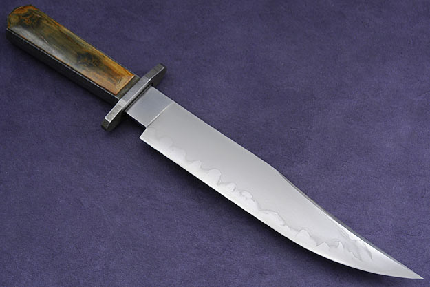

To get a good hammon, does it matter how thick the clay is on the blade?
Gday guys,
What is the advantage in having a "thin as possible" coating on the edge? I would have thourght you would want this bare so you could watch the colour etc before quenching.

Clay thickness also depends on blade thickness. I have tried clay coating a few blades that were slightly thinner than 3/16ths and there was 1/4 inch of clay on either side and it hardened right up underneath that clay, using 1084.
Good point Bill I forgot about the manganese, I wonder if results would have been different with 1075? What steel do you use for getting hamons Bill?
When you heat in a fire and do not allow the spine to reach critical, is one of your worst failures where you got a longitudinal crack right along the line of clay? It has been my fear that that would be a problem encountered with that method.
