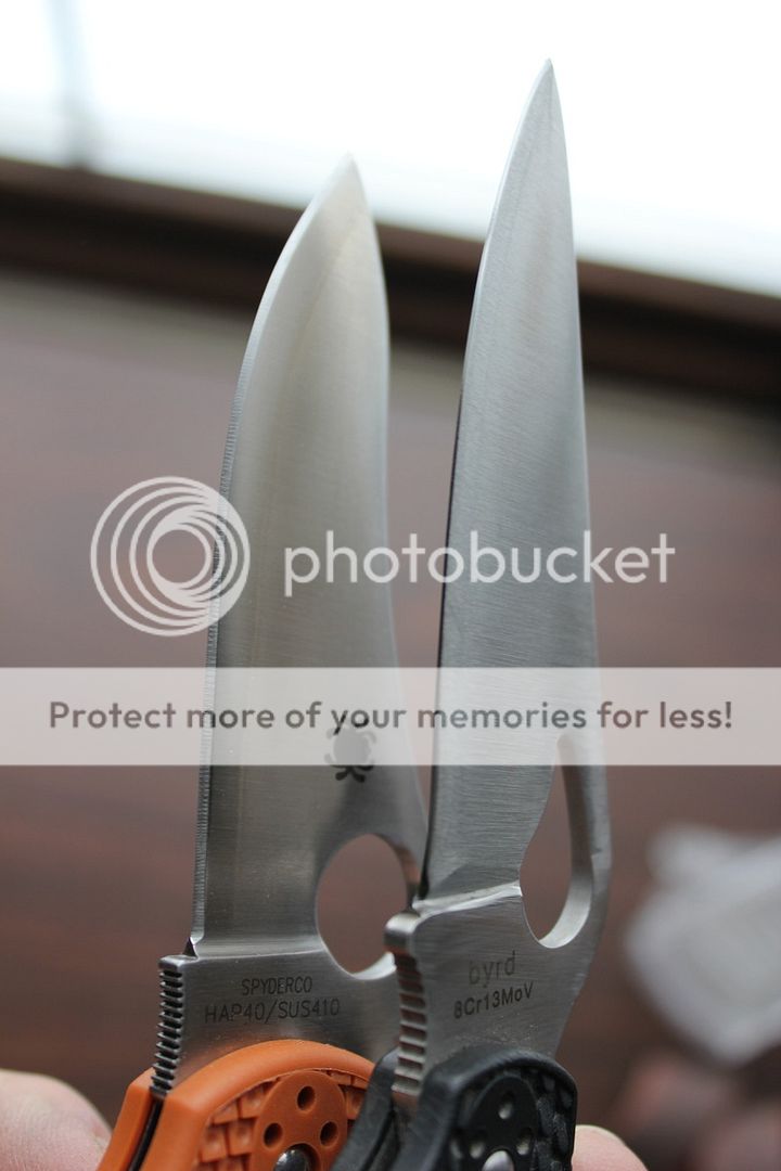

I just picked up a new Stretch and I'm curious how they get that toothy edge and have a bur free finished apex? I debur on a paper wheel or a 1x30 leather belt and inevitably end up with a polished edge (perhaps just a lighter touch is needed?). My polish edges cut paper and shave better that these factory edges, but these factory edges (like on my stretch) feel so sharp when giving them a three finger touch and I'd like to know how they achieve such an edge.
