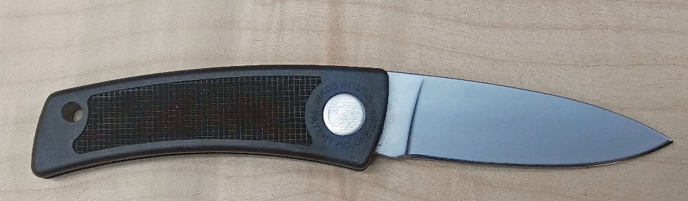

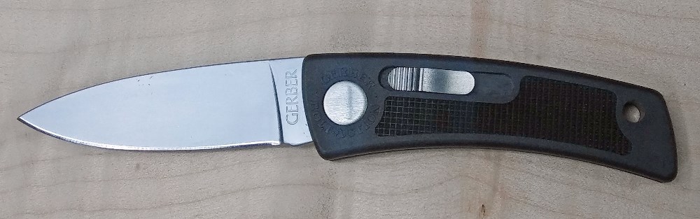

I've had this Gerber Bolt Action since early 80's but it has mostly sat in a shoe box of other stuff. Any type of pocket clip I can attach to this?

If you must add a clip, then I would try to rig something that bolts through the lanyard hole. Kinda like a regular clip for a Chris Reeve Sebenza, just bolted straight through the existing hole. That way you could avoid permanently altering a rare-ish pocket knife.

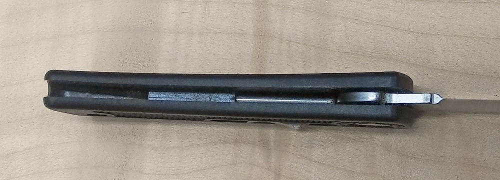

It may be possible to drill and tap the handle for screws to attach a clip. Knifekits.com sells a variety of pocket clips. Others can also be found online. There are many varieties available.
Or, if tapping isn't a viable option, depending on the width of the gap between the handles, it may be possible to use some of these stainless steel threaded inserts by drilling holes, then installing the inserts up into the holes from the inside of the gap. These inserts are threaded for 2-56 screws, and the rims keep them from being pulled through the holes when the screws are tightened.
Available from McMaster. These ones pictured are 1/8" long, but they also come in a shorter 3/32" length. 1/8" long part number 92985A814, 3/32" long part number 92985A813.
I seem to recall that some models of those Gerber Zytel-handled folders originally came with a clip that did actually attach through the lanyard hole itself. I have an old Gerber LST of similar design and probably early 1990s vintage, and I think it originally came with a clip like that, also in Zytel or nylon. I'd removed it a long time ago (no clue what I did with it), as these knives were so light & easy to carry in-pocket.
