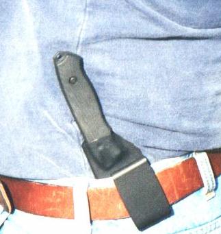

Does anyone know of a good source to order metal clips. What I want to do is attach the metal clip to a kydex sheath for pocket carry etc....
Also, how are the clips typically attached to the kydex for a clean look. Are they screwed on or attached with rivets?

To be quite honest the standard metal belt/boot clips that you see on most leather sheaths are not nearly strong enough to hold a kydex sheath securely..
I have only seen one clip that even comes close to holding a kydex sheath in place on a draw,, and you are Very limited to belt size with it...
Why not just install a G-clip on the sheath, and you'll know that it's held in properly...

A g-clip is a folded over piece of kydex, when you look at it from the side it looks like a Capital G
G-clip in this picture is top right.
It is a Very secure system that I've been using since I started and that others have been using long before that...
It can also be flipped over to use for OWB carry...
Very versatile belt loop...

Thanks JB! That is exacty what I was looking for.
Normark I will give the G clips a try. Do you make those yourself? If so, how does one going about making them?
