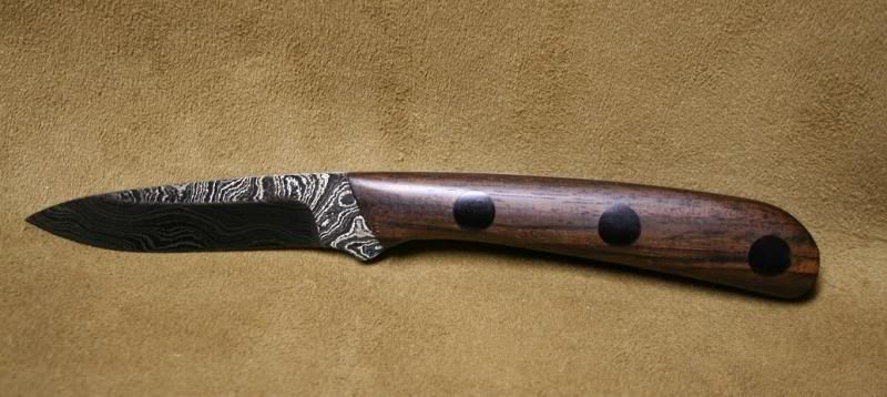

Just showing you one of the blanks I finished myself. Alabama Damascus blank. While I cant wait to make my own knife from start/finish .. I still have some pride finishing a blank.

Thanks dude! .. so start small, get a cheap blank, scales, pins, and some sand paper .. see if it tugs at your emotions.
If it helps, I've put in $500-600 so far, not including the gift of kiln ($450), and I am at the stage where I can take a knife from bar stock to a heat treated, finished blade. I really wish I had all my receipts so I could break it down into a list (and claim for taxes). My tools are basic: hacksaw for cutting blanks, files for refining profiles and cutting bevels, sandpaper, 5 ga veggie oil, steel quench bucket, steel heat treat foil, drill press and bits, arbor press, 4x36 belt sander (get a 2 in belt grinder if you can), clamps, a vise, and parts for an electric etching machine (just started putting that together). I've been at this since June, collecting bits here and there as I go. Try to purchase your tools and materials in the order that you will need them and you'll spread out the burden on your wallet. Also try to have a good straight stick of dimensional lumber on hand for making sanding blocks, jigs, etc.
