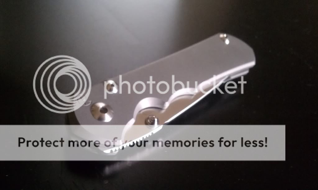

So I want my 25 to have silver lugs instead of the blue. I'm sure its pretty easy to do so but I'm not sure how to do it.
I don't have a dremel or fine sandpaper, I have a bottle of flitz and some other house hold items. Any suggestions or
tips on how to do so would be appreciated.

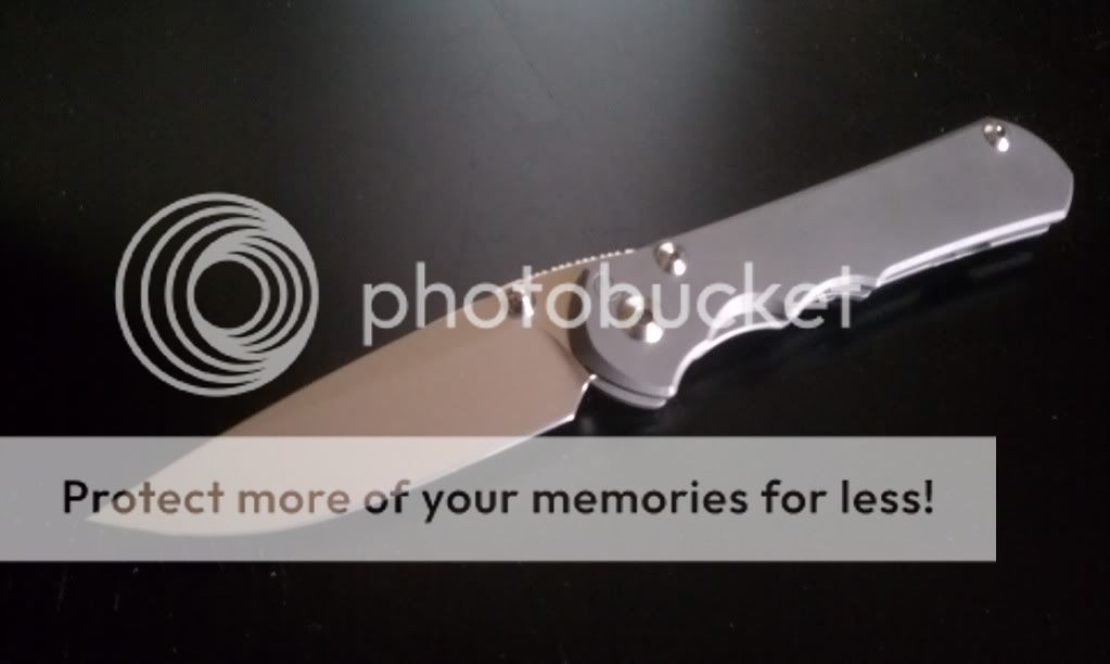

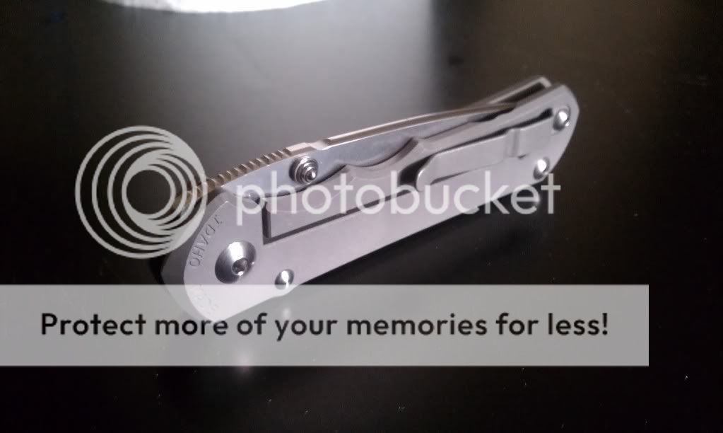

Had a hard time getting all the blue out the grooves but with
a little patience it turned out great. Absolutely love the 25.
