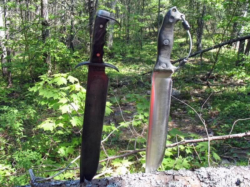

I mean we KNOW that the Battle Mistress and Basic 10 & 11 made from INFI are great choppers . But now we have Scrap Yards Dogfather made from SR-77 , the new Swamp Rat Rodent 9 made from SR-101 which is NOT through hardened and Scrap Yard will be releasing it's 911 made from SR-101 that IS through hardened . I'm not aware , but does Swamp Rat also make another large chopper like the Dogfather ?
Anyway what are your opinions of what would be the best all around chopper while still being very tough ? This is sort of like the "if you could only have one knife" theards , but this one is , if you could only have one chopper lol . Lets hear it from some of the long time large blade users here .

I have chopped tons of firewood with Hogs, Rats, and Dogs, and I really think you would be hard pressed to find a better chopping steel than INFI. SR-77 is tough as hell and great if you just want to beat the hell out of a knife, but doesn't hold an edge all that well in my experience and is rust prone. When sharpened correctly, SR-101 takes a WONDERFUL edge and holds it very well...but it very prone to rust. SR-101 can also chip if the edge is too thin. INFI takes a great edge (not as good as SR-101 IMHO), holds that edge extremely well, and it very resistant to corrosion and edge damage such as chipping. These generalizations are based on my experience so take them with a grain of salt. I still prefer to use my Rats on a daily basis, but if I need to chop the hell out of something...out comes the FFBM :cool:
As far as the large choppers, it would have to be the CGFBM for me. A little lighter than the fat girls (not that there is anything wrong with that;)) and a total chopping machine. The INFI takes a beating from everything and will steel back out if dinged, it has great flexibility as well. For a camp chopper, I prefer the HHFSH.

So do I have this right now ? SR-101 can keep a better edge than SR-77 of even INFI but is not as tough as a chopper or to batton ? If a big INFI chopper is out of the question , would a Dogfather be the next best thing or might the Swamp Rat's rodent 9 or Scrap Yards 911 (when it's released) in Sr-101 be as good or better as they are 9 1/2" ?
I know many of you have several of every size , but I really only need and can only afford ONE big chopper , so I'd like to make the right buy the first time .

Yes, SR-101 does keep a better edge than SR-77 and if "cutting" fine material such as meat or loads of paper will hold the edge longer than Infi or as long as Infi ... chopping wood however does'nt seperate the two on the cutting front ... whittling wood would show a difference but that depends on the blade's "edge profile" ... in my experience Infi if taken thin to give a cutting edge is more likely to roll at the edge compared to SR101 if at a similar thin profile ... however that "rolling" attribute to Infi is an advantage when chopping because if you are chopping near the ground and clip a stone the edge is more likely to roll and be able to be steeled back into place ... than chip out and have a permanent ding in the blade until the whole edge was re-profiled.
SR 77 is more like Infi in that it too is less likely to chip out ...
Chipping out the blade therefore is more of a possibility for SR101 but even then the heat treatment on the SR101 is so good that the brittleness you can aquire in steel if you go for a harder steel is minimised. Harder steels hold edges longer as they don't roll as easily but a ding in the edge can be a problem when "cutting". If chopping wood it is more likely to be just a "cosmetic" blemish.
Allowing for guys who have processed huge amounts of wood with Chopweilers/Ratweilers/Battle Rats/Camp Tramps without any issue ... if it were me I would be happy going with SR101 for my one chopping blade. I would prefer it to SR77.
However, what is your budget ? Check out ASM Basic 9's on the exchange for $400 and Basic 11's for around the same money.
When people say SR101 holds an edge longer than Infi in my opinion this is often because their Infi blades are taken to 30 degree inclusive edges ... i.e. thin enough to "roll" ... however with a 40 degree primary bevel and a 30 degree secondary bevel to thin the shoulder of the edge for less cutting resistance ... then Infi stays with SR101 as it is less likely to roll and simply blunt's by wear on the edge. Infi has remarkable longevity on the edge if it is just down to wear and tear. Ankerson uses this on his NMFBM and I put this on and then covex the secondary to the primary ... so nye on identical but smoother ... and we both reckon that this type of edge works best. Ankerson does loads of chopping and cutting ... check out his video's ... and I have done a good few write ups too.
IMO Infi is a better all round steel once you get to know it ... if SR101 were I would have sold my Infi a long time back. :thumbup:
