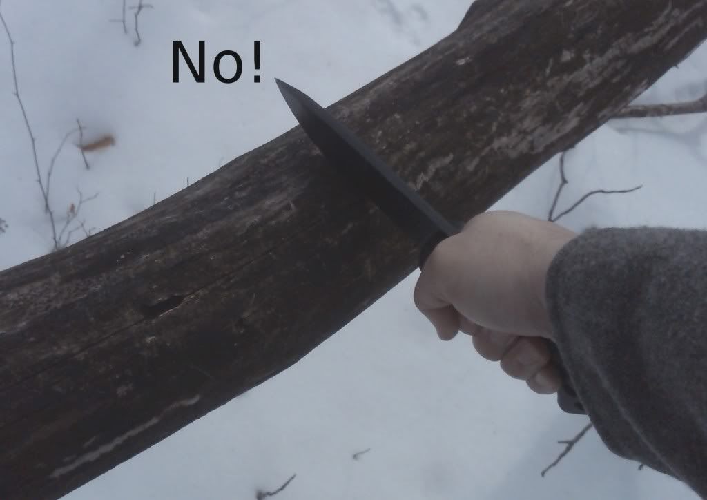

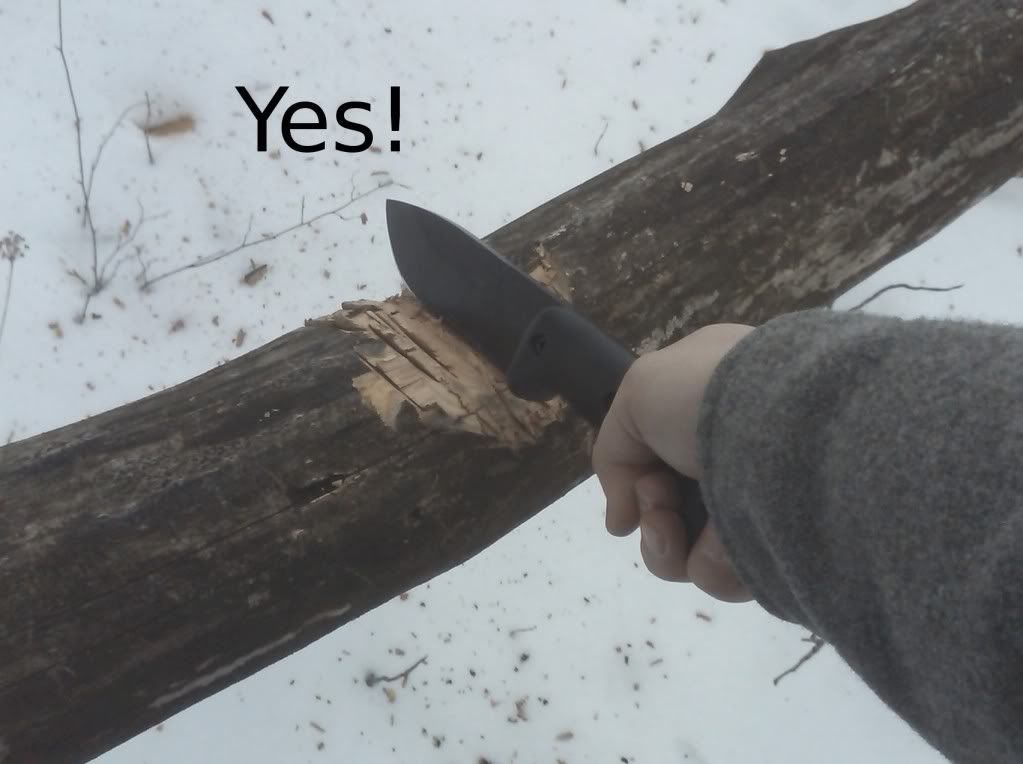

Yeah to chop with the BK2 I slide my hand down low on the butt of the knife and wrap a paracord lanyard around my wrist.
Great photos, Kahn! Are you using a lanyard in these pictures? It looks like you don't. Watch out, we don't want anyone to get injured!
ETA: The whole forum must think we're going nuts.
I'm not. Grivory is plenty grippy, but if I lose control of the knife, I'd rather it fly away from me than be attached to a rope around my tender young wrist. There's blood and stuff in there. :p
